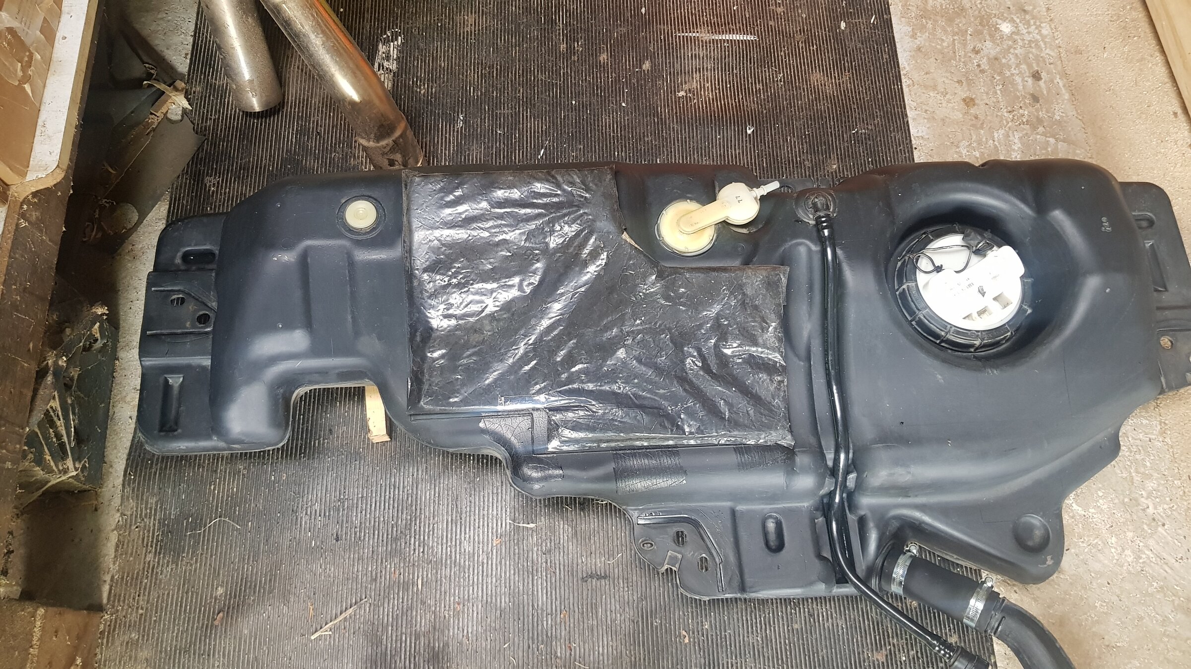

The black plastic wrap around my fuel tank pad has disintegrated, I think if I put just the foam back it would sponge up water and hold it against the floor pan.
Would wrapping it in a black bag work, any other ideas?
DomP182
  ph1 172, Arctic182

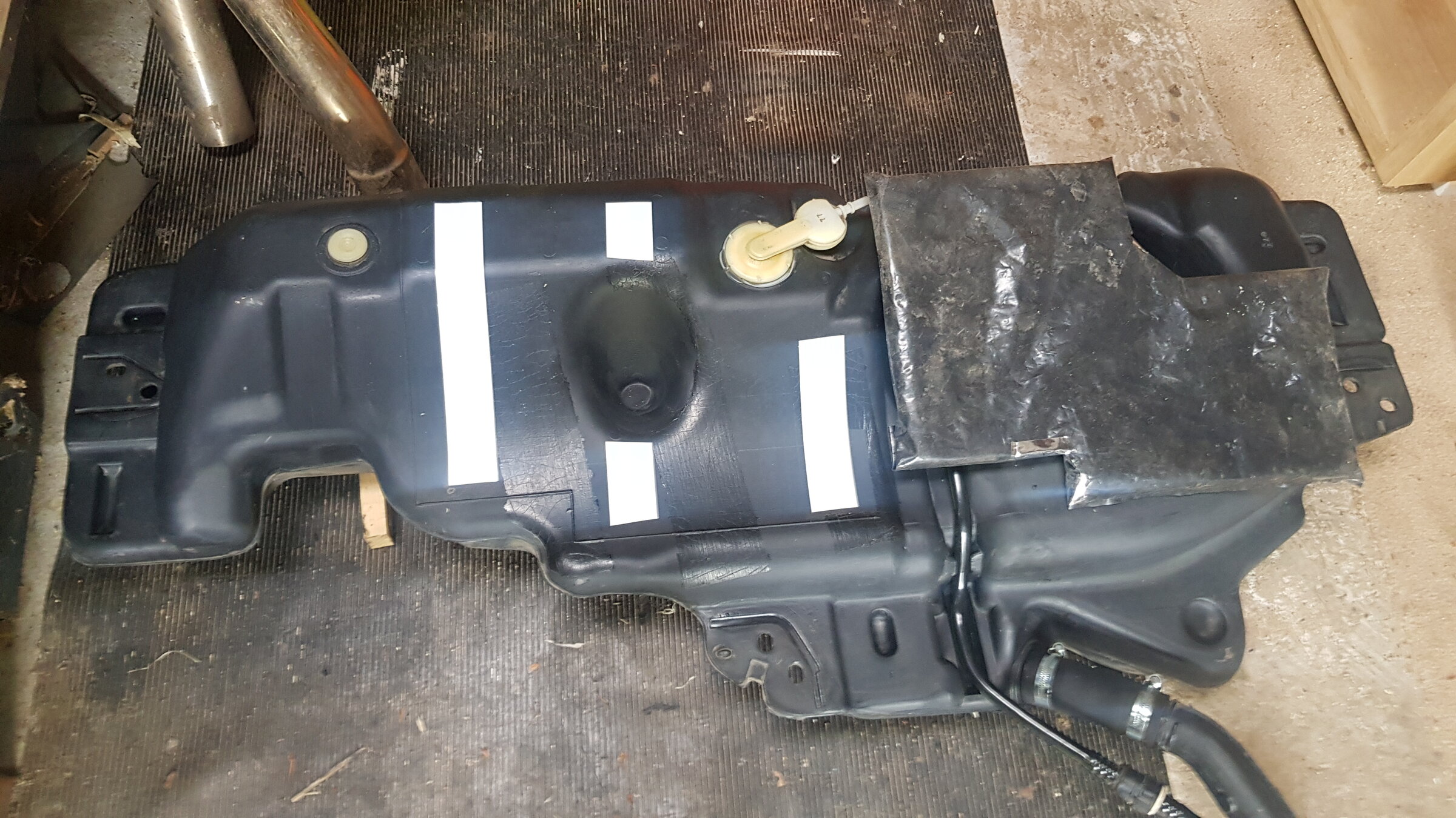

Rubble sack, aluminium tape and worktop edging tape. Problem solved!
