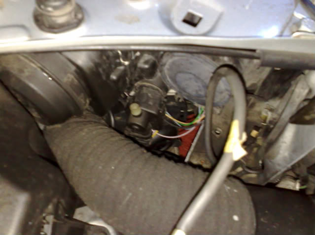

funny noise from near passenger head light?
Car  Clio Sport 172
it seems to be coming from this area:
and sounds like this:
yeah that sounds like it is a knackered adjuster as rich-6 has said. It happened on my 172 when i'd just bought it but luckily the car was still under warranty so my local renault garage sorted it for me.
you can see it in your pic. it has a little off white colour adjuster ontop of it that an allen key fits into. nearly dead centre of your pic
Nope they just twist out. Then you remove the end of the adjuster from a groove in the back of the headlight lense.
i dont mind any more my dad has sorted the gararge out i bought it from and they are doing it on the warrenty now ^__^ yay, after i rang yesterday and they said no. LOL
