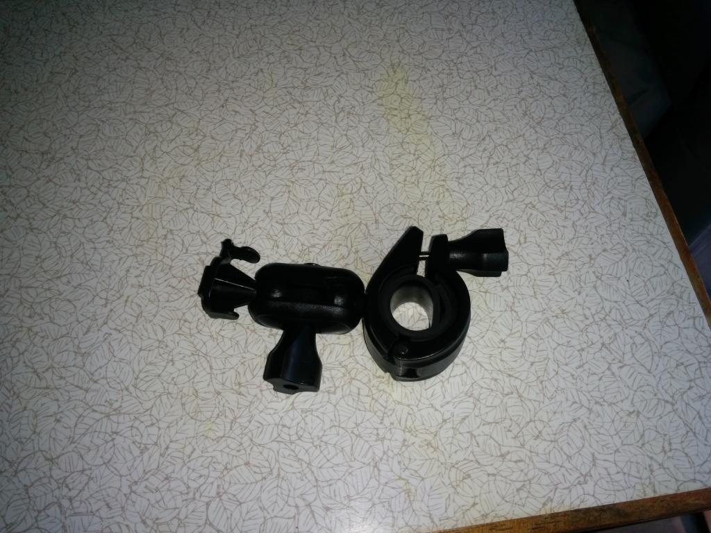

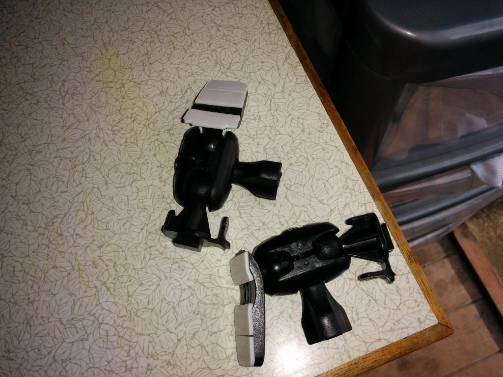

So, a month down the line and now with a second G1WH for the rear, I decided to mount them a little more permanently than can be done with the supplied suction mounts.
The camera/memory card/mount bundle I bought had a rear-view-mirror stem mount that didn't fit around the mirror on my ST. Wanting something stuck to the windscreen I thought I could make something out of this redundant mount;
I started with this

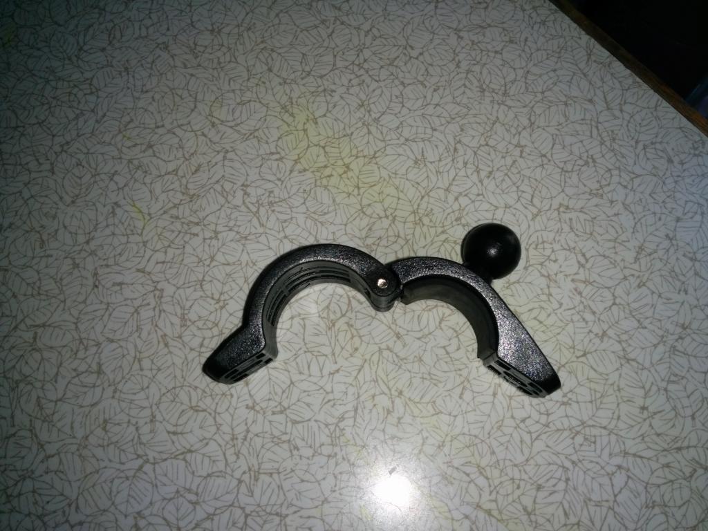

which I disassembled until I was left with this

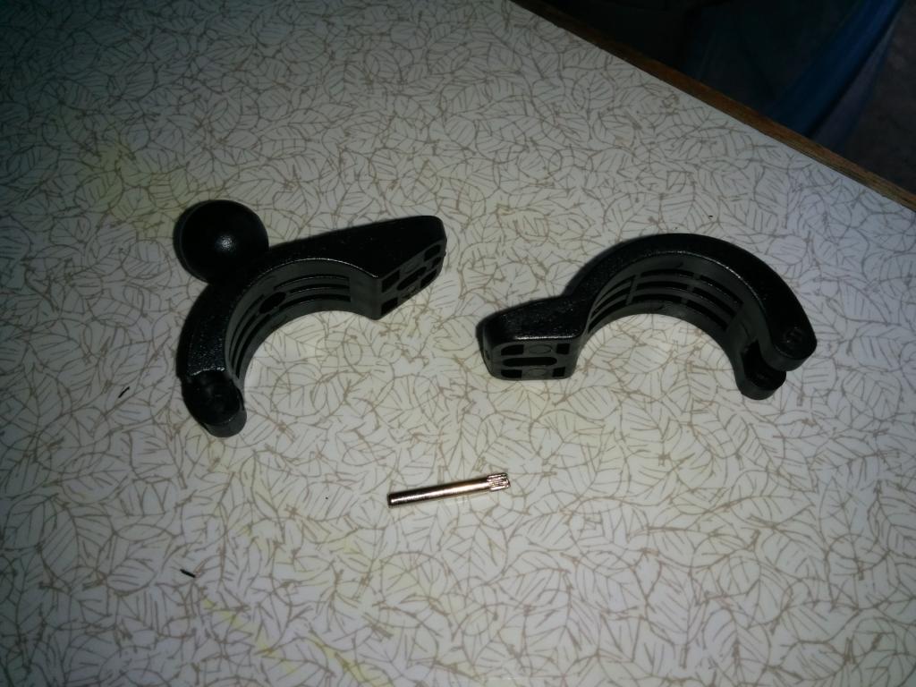

then drifted the pin out to separate

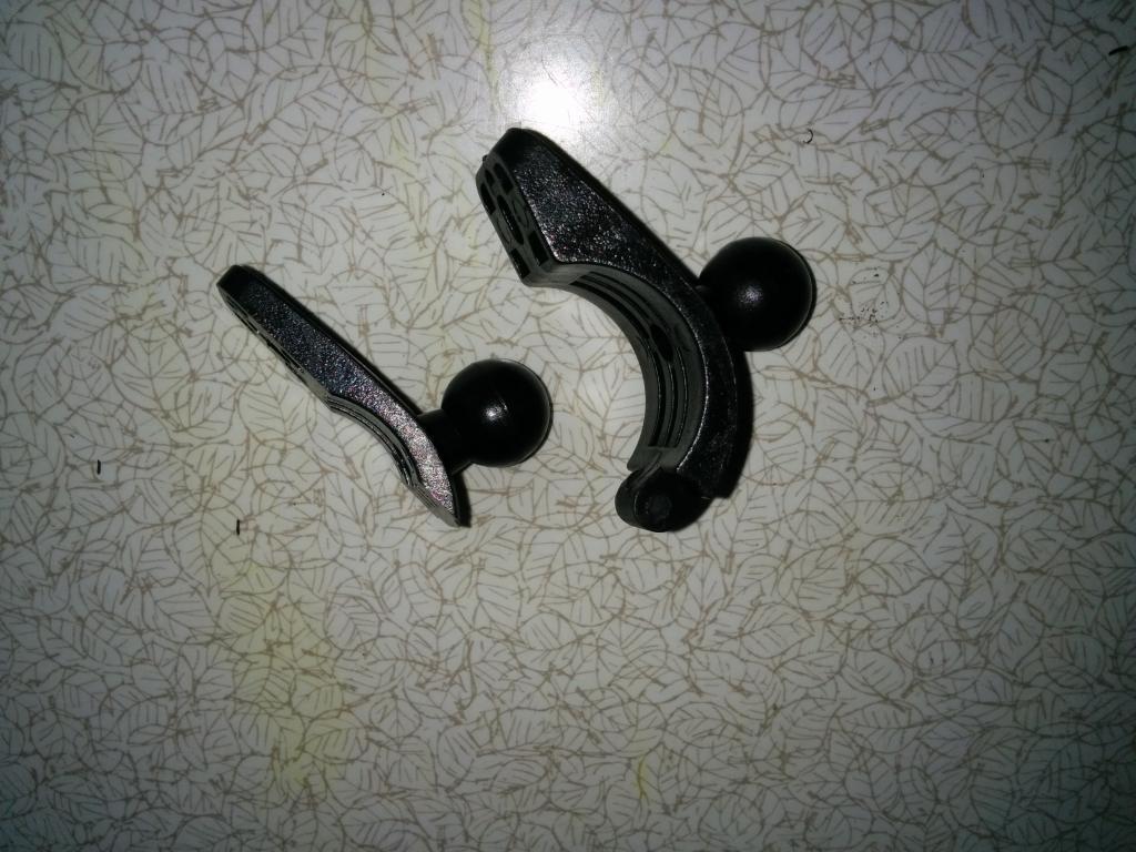

before gingerly going at it with a saw and some wet'n'dry giving this (before and after)
then reassembled with some sticky pads applied

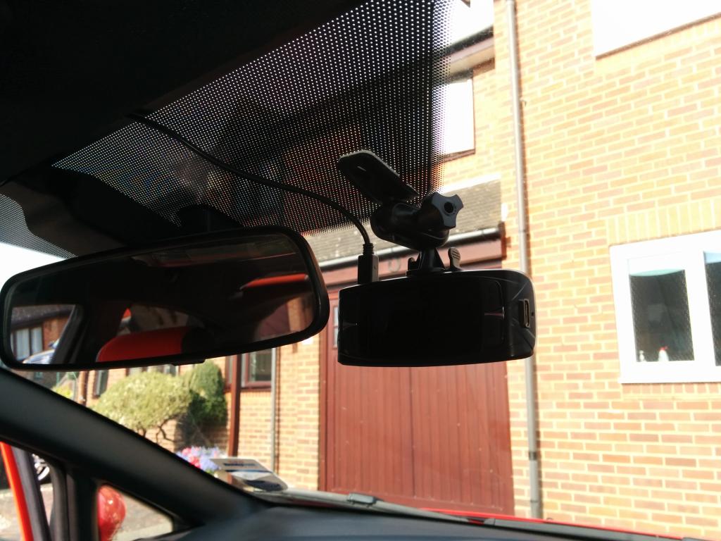

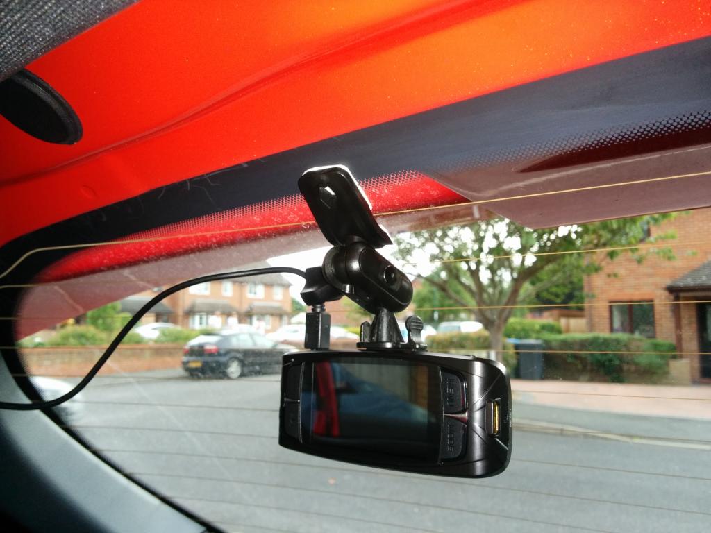

and then both mounted front and rear
I'm very happy with how they've turned out, securely mounted, nil vibration, minimal effort required.

That's an awesome way to mount them, how long have they been stuck down so far, were the pads anything special?

Only stuck down since last night so far...nothing special sticky pad wise...Sellotape Permanent Stick Fixers. Past experience with these (using GoPro mounts) has shown them to be ore than up to the task.
As for the rattly mount...that's another reason I wanted to move to the rearview one as it has a clip/release toggle on it so locks it in once it's seated fully home.
