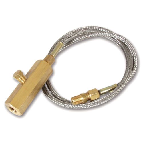

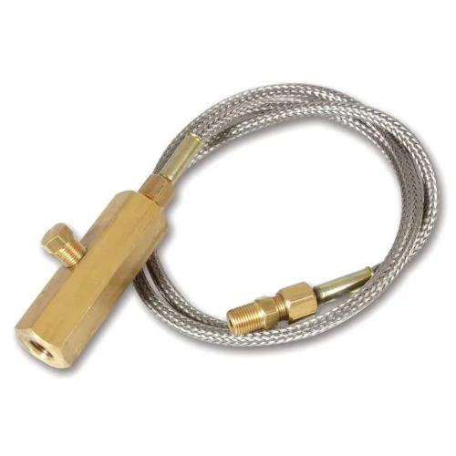

it's the way I'd do it, either that or on a sandwhich plate off the filter.
I've not run one myself, but I do have the oil pressure T'd off alongside the standard pressure switch
I used the oil pressure T piece as shown on the MLR website, but with a 0.5m braided hose extension as the T-piece alone pointed the gauge sender into the oil filter.
