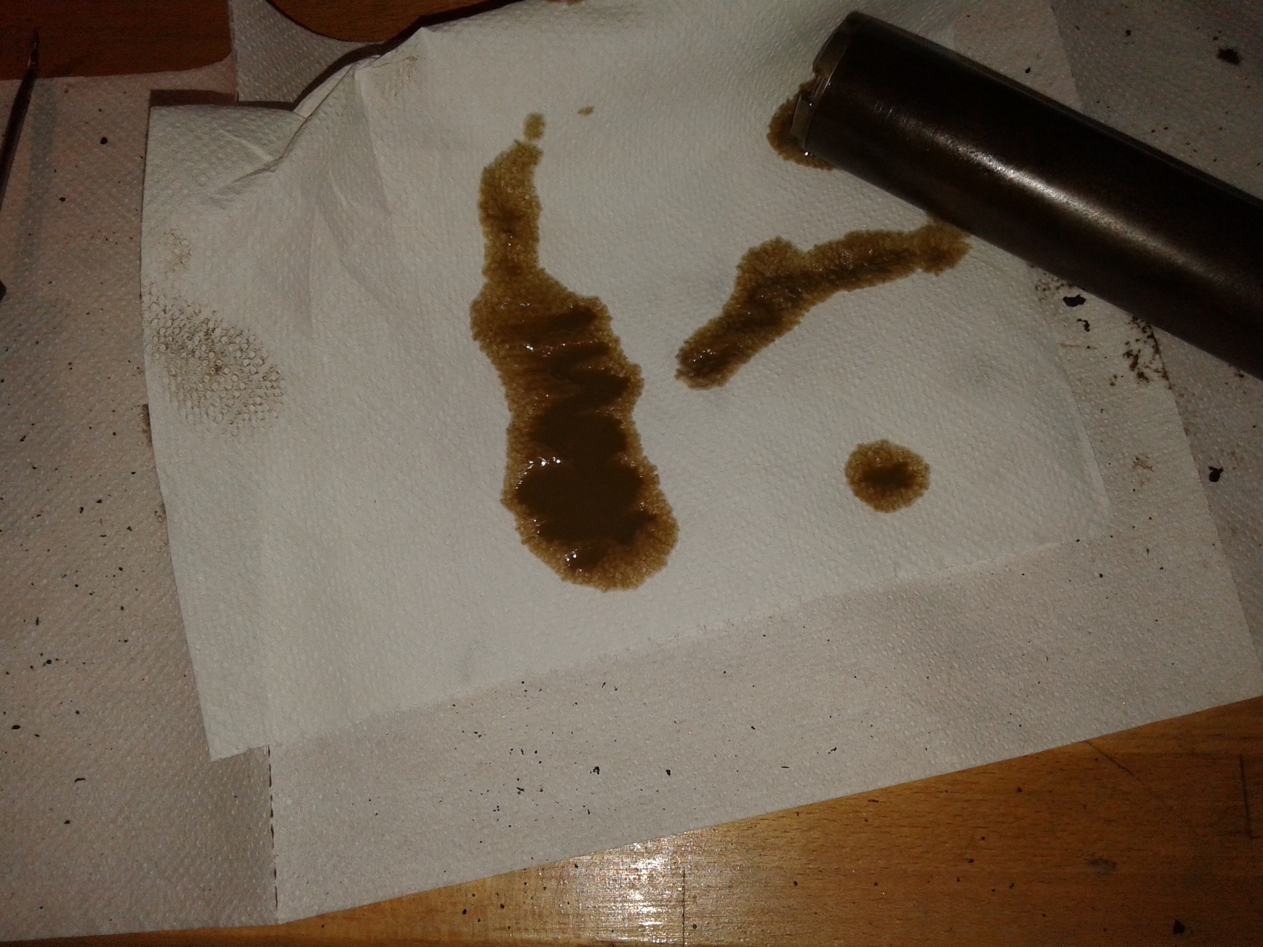

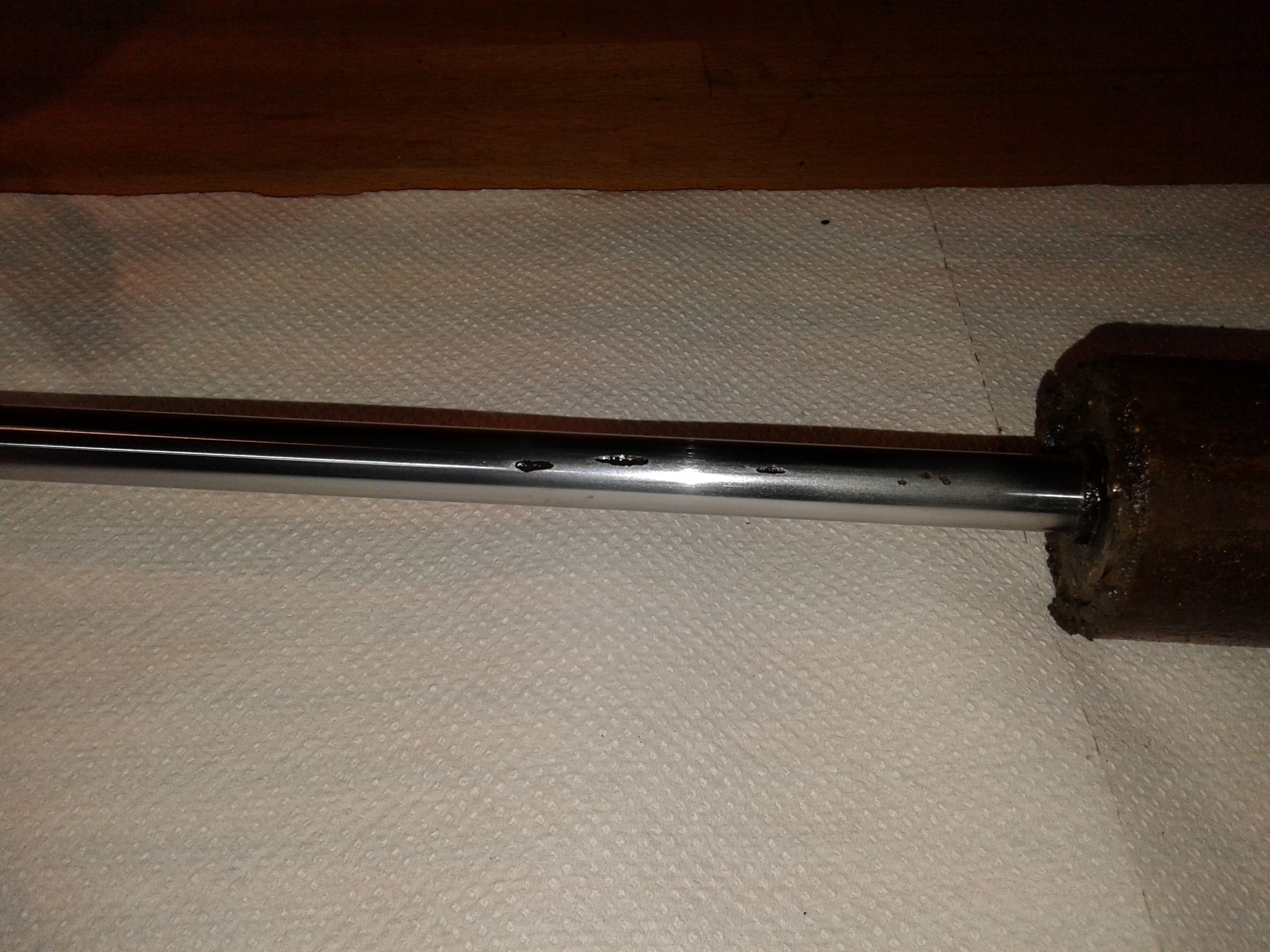

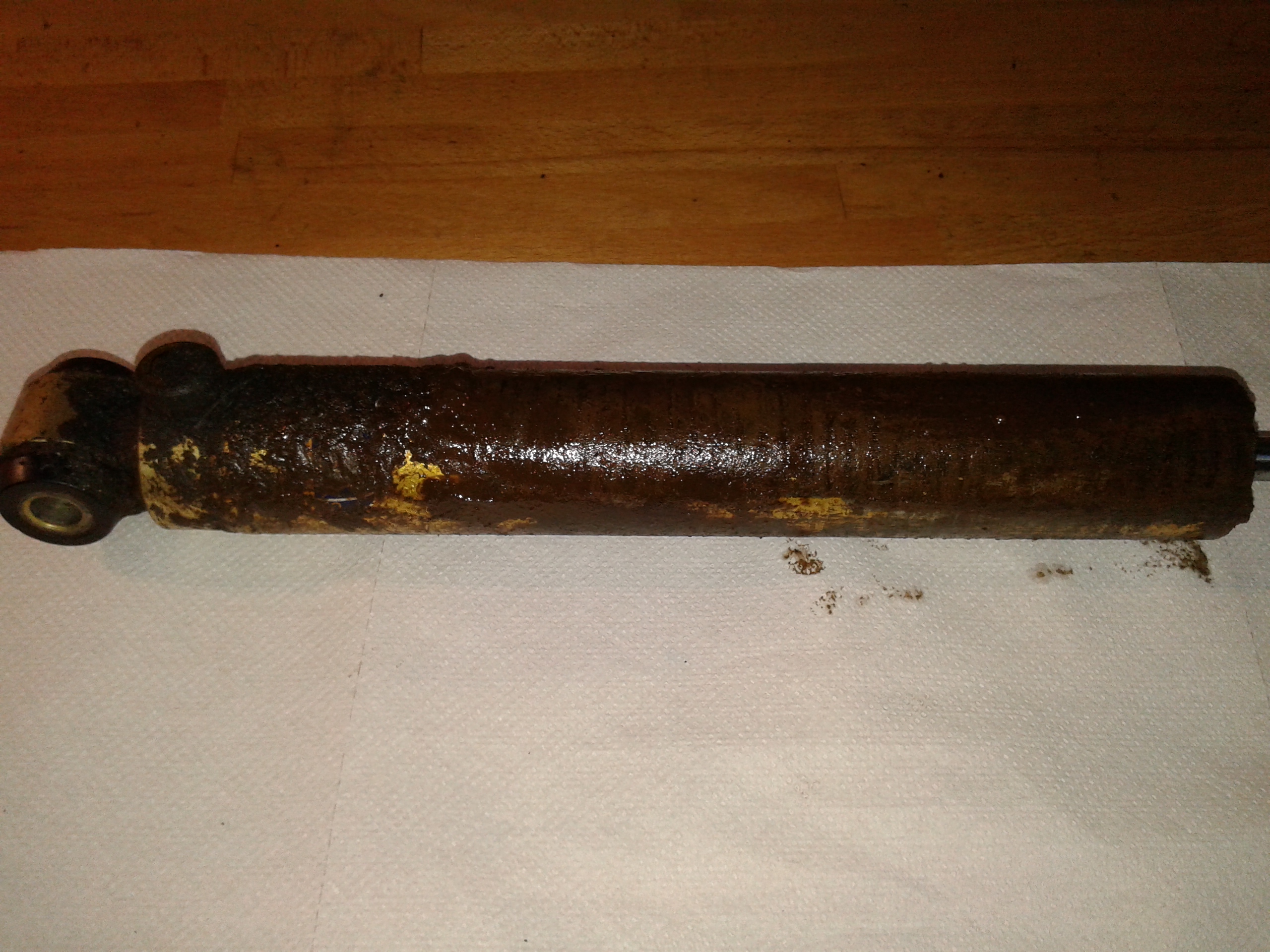

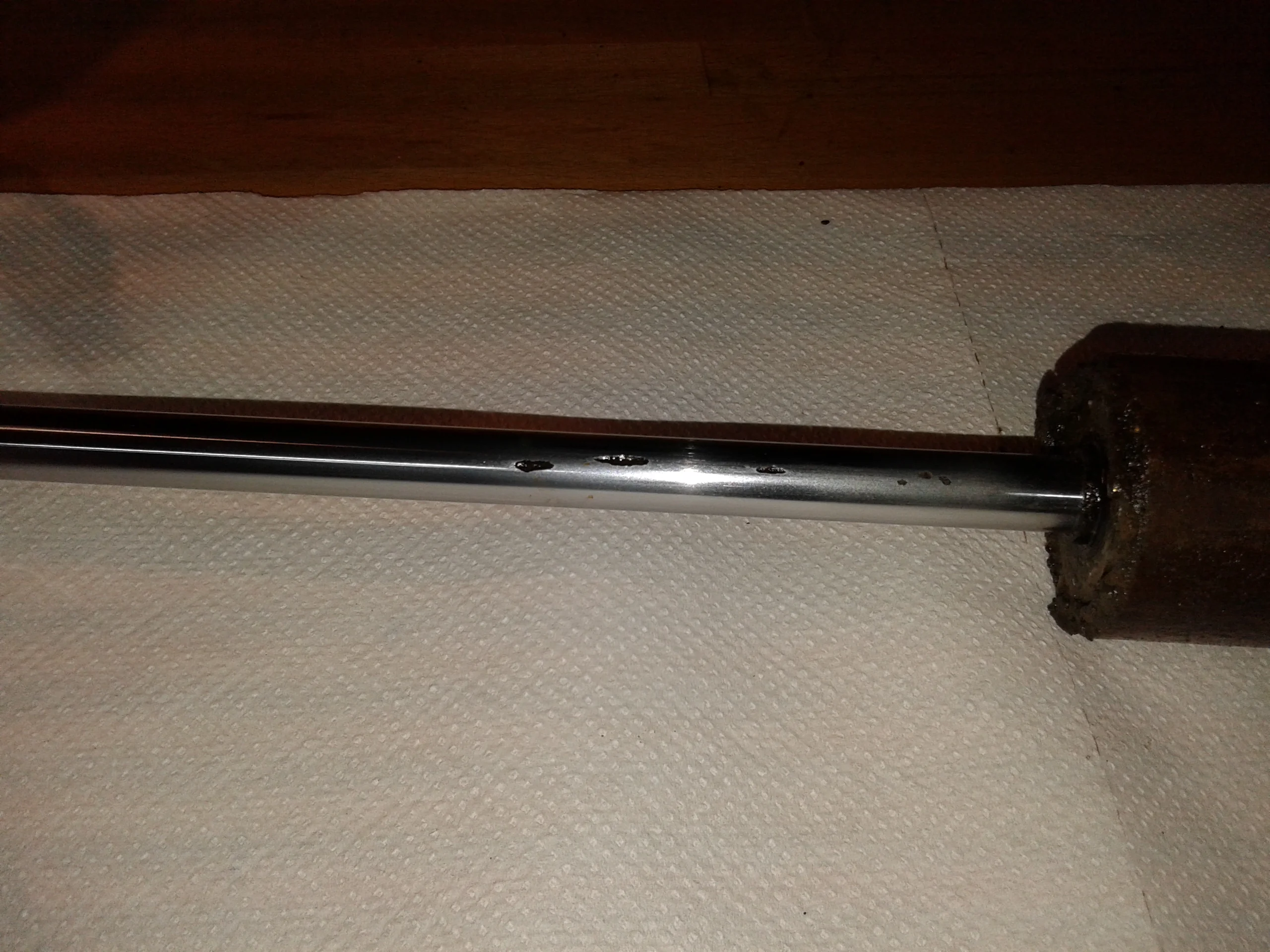

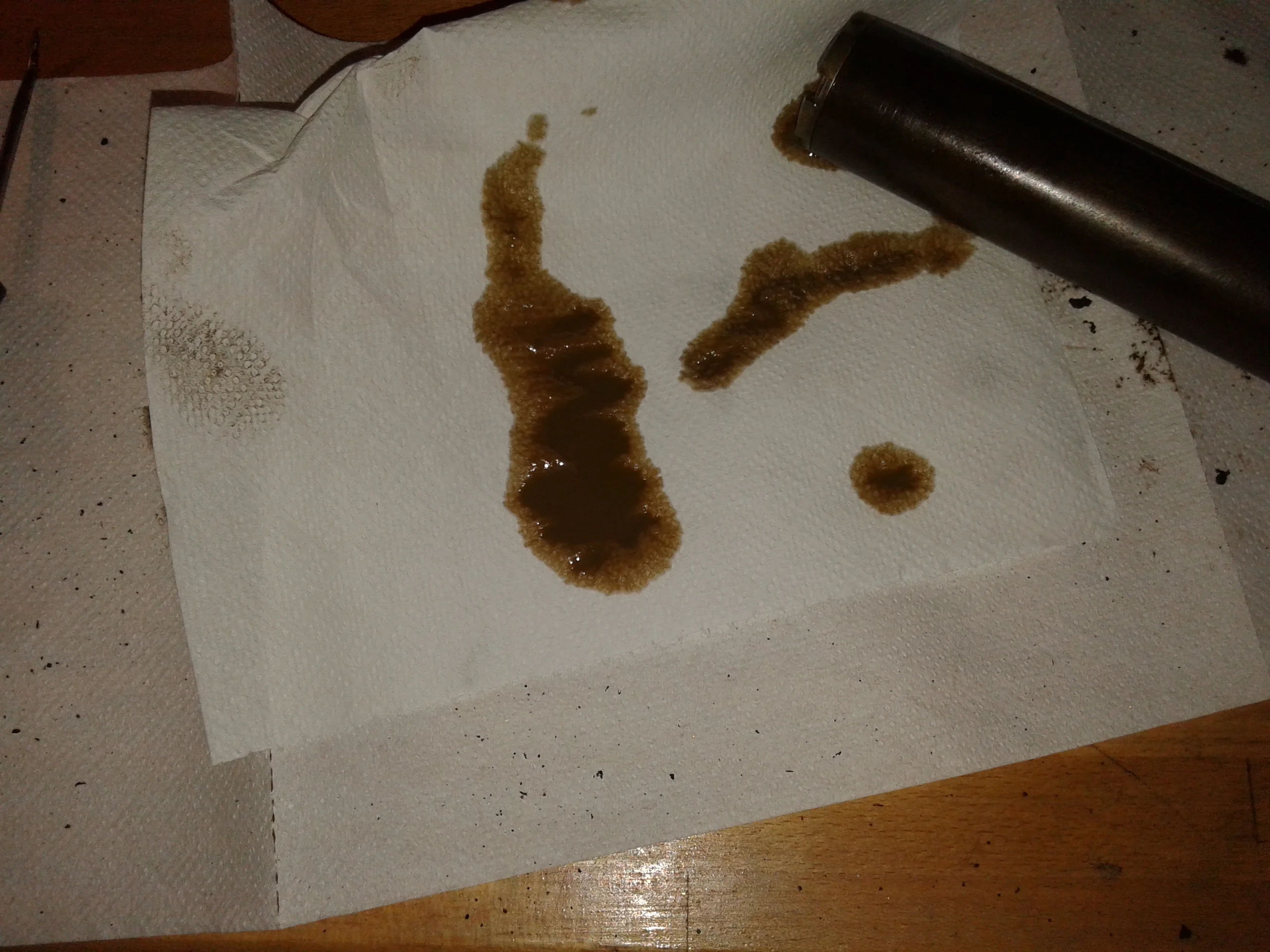

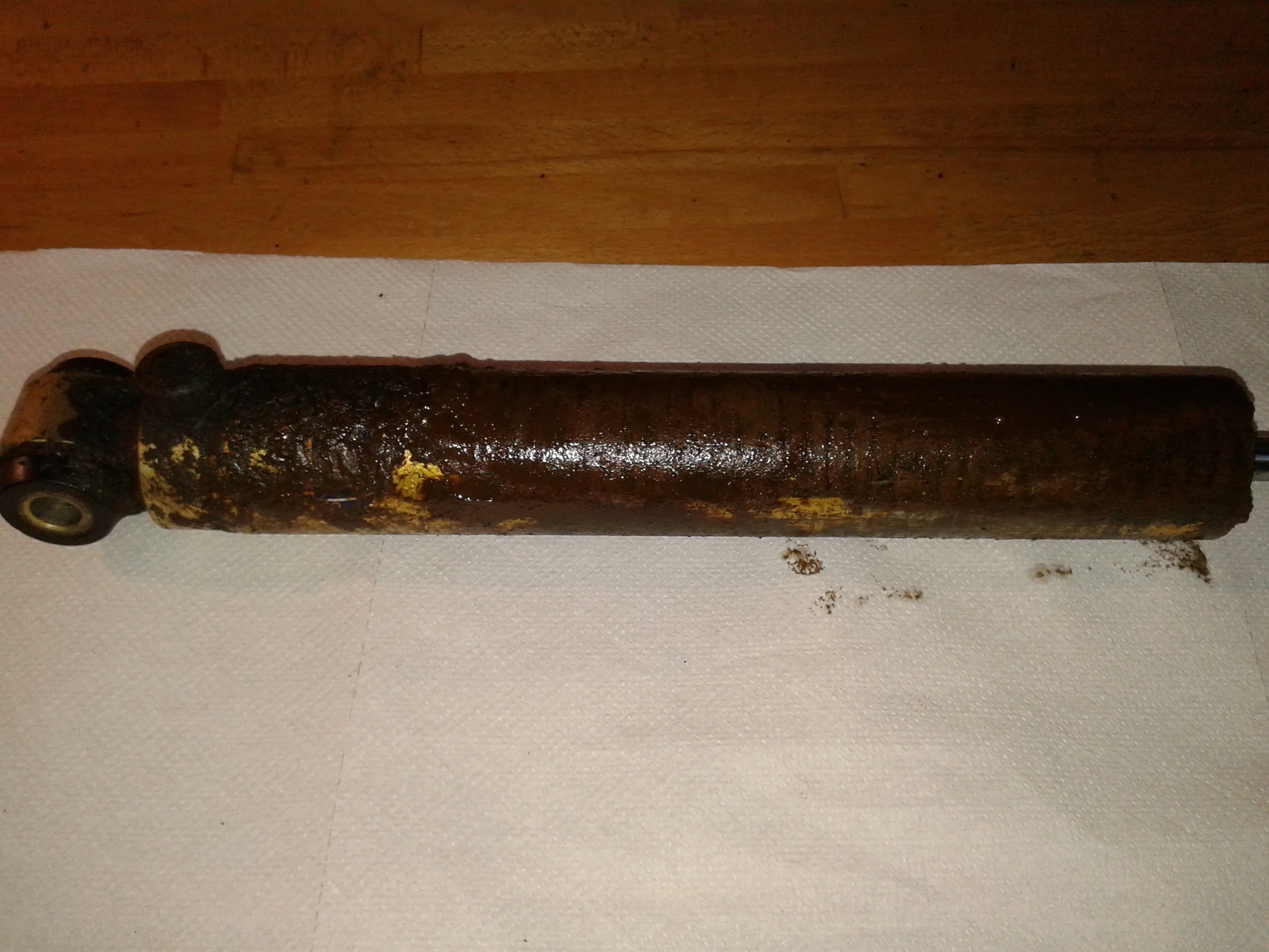

Ever wondered how a f**ed up GAZ looks inside?
I have a bikeshop (working on suspension forks raised some questions) and was dead curious how they are so after receiving my new set of coilies I took one front shock apart to see what's inside and found ... disaster!
Have to say that they gave up after almost 4 years of use and no refurb whatsoever.
But still.. to find rusty old damping fluid, rusty internals and chopped rods was a bit of a "wow I didn't expect that" thing.
My curiosity started when thinking why the Fox fork on my bike costs almost twice as much as GAZ coilies.. And found out why!
Firs of all the damping mechanism is really simple, and there is absolutely no stainless or another rust proof component used, apart from the shock rod. Sooo curious on how more expensive kits like the bilstein are made!...
There were two dampers on my car that leaked, and both had the rods damaged, suppose that was the cause for the water and debris getting inside, since the other two were in a much better condition.
Have to aske myself why don't they use damper covers like many other manufacturers? these would probably prevent the rods from being damaged. And why on earth don't they just paint the rear dampers like SPAX or Bilstein? you can see how badly coroded was mine in one of the pics.
My advice if you own GAZ:
Get them refurbed once a year or two and a set of coilover neoprene socks may be a good investment..
