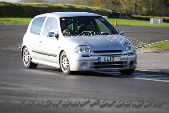

Gaz are VERY hard,
This is a pretty sharp left hand bend at approx 60mph (I dont know I dont look at the speedo)
As you can see the car does not have much roll. Great for track but on a road car :S

Ive heard the Gaz coilovers are pretty bad but i cant see the problem looking at the snap above, surely you want a firmer ride and the car flat through the corners, can anyone elaborate why there so bad?
