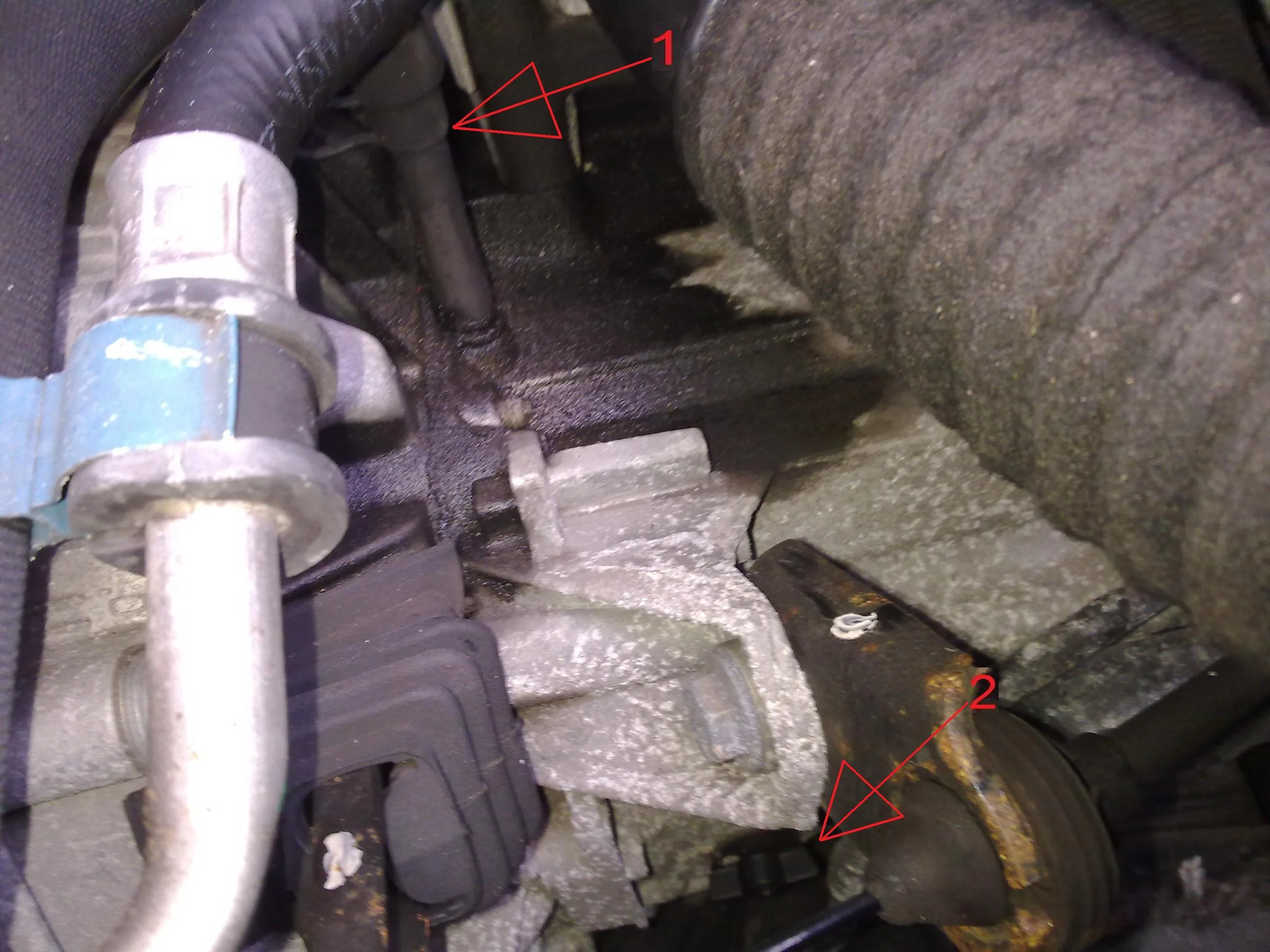

P PeterB Car Clio 182 Mar 3, 2011 #1 Planning to change the gearbox oil and just wanted to check id got it right Do I pour the oil into 1 until it reaches the level of hole 2 and starts coming out?
Budgie Car 330i. E30 Touring. Mar 3, 2011 #2 Some do it that way. I always use a funnel and length of garden hose in hole 2. 3 litres. Bang. Job done.
B bmh.01 Car BMW M135i Mar 3, 2011 #3 No no no no no. No.1 is the box breather, no.2 is the fill/level plug with the drain plug being on the bottom of the box.
P PeterB Car Clio 182 Mar 3, 2011 #4 But surely by pouring it down the breather its just gonna end up in the box? or is it just easier to fill through no.2?
B biojo Car Clio 172mk2 Mar 3, 2011 #5 number 2, think of how narrow number 1 is and thickness of oil youd be there all day getting 3ltrs in
