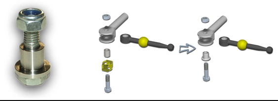

Louis I Love Ed Sheeran ClioSport Club Member Car BG 182 Jul 18, 2018 #1 I've seen these just recently, and i'm wondering if anyone has fitted one of these? I believe it's Yanoo who developed this and it seems like a pretty simple fix! Would this tighten up the shifter some more? Last edited: Jul 18, 2018
Brigsy ClioSport Club Member Car T.Turbo Jul 18, 2018 #2 Should make a difference if tight fit. I know a couple of people who ground the oem bush down making it tighter on the gt turbos for less slogger.
Louis I Love Ed Sheeran ClioSport Club Member Car BG 182 Jul 18, 2018 #3 I've messaged Yanoo now to see if he still makes them, and found this - http://williamsclio.co.uk/forum/showthread.php?37605-Gear-linkage-metal-bush. I'm making my own shifter so just thought this would be a nice addition to stiffen it all up!

Louis I Love Ed Sheeran ClioSport Club Member Car BG 182 Jul 18, 2018 #5 imprezaworks said: Let me know how you get on with that mate Click to expand... Will do, i'll have to have a look at my clevis bar as apparently this makes a difference? He sells them with his short shifter kit on his website.

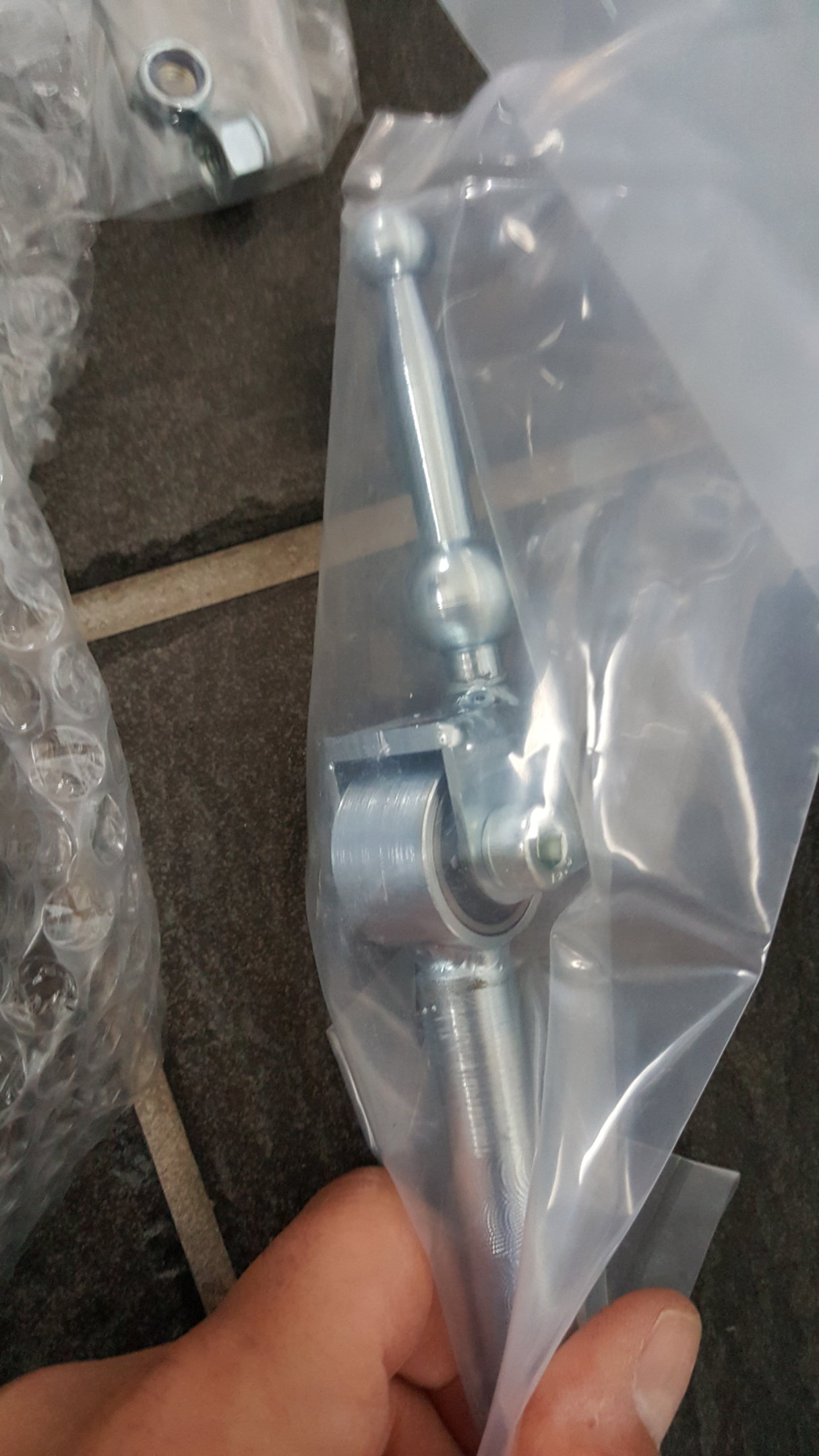

Brigsy ClioSport Club Member Car T.Turbo Jul 18, 2018 #7 Pms shifter has a cartridge bearing fitted, might be worth seeing if you can fit one instead of a bush.
