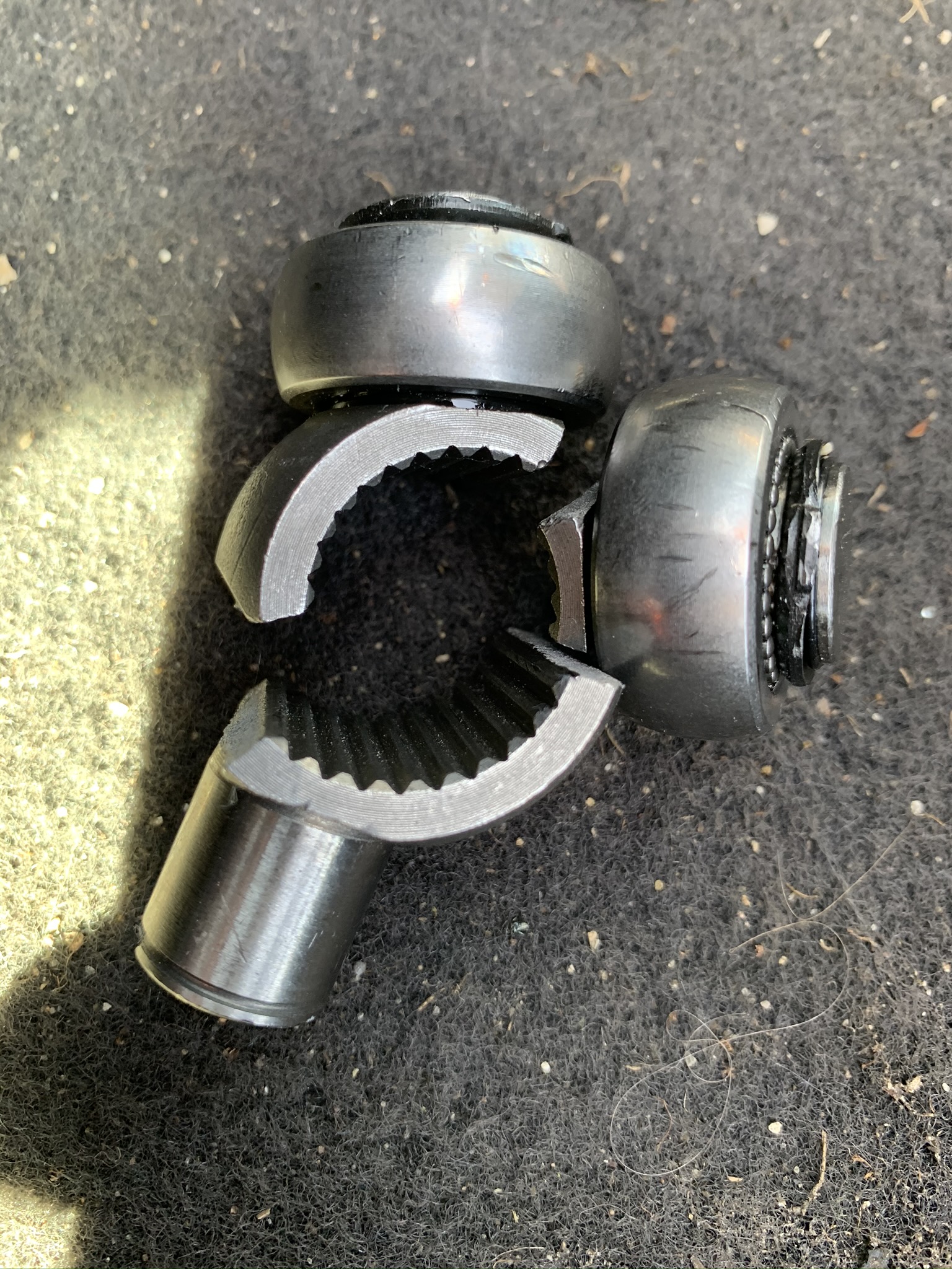

Running second in class on the last test, when changing from first to second i got a thud and no gears.
Had it recovered to a good motorsport specialist (who where at the rally), who have identified that the N/S driveshaft let go at the gearbox end, and bits of the tripod thingy are in the box.

If it’s lost the needle rollers out the tripod joint, it 100% needs to come apart. Those needle rollers are harder than the gates of hell and do break gear teeth I’m afraid.
Probably not what you wanted to hear, but it’s something I can sort for you mate.

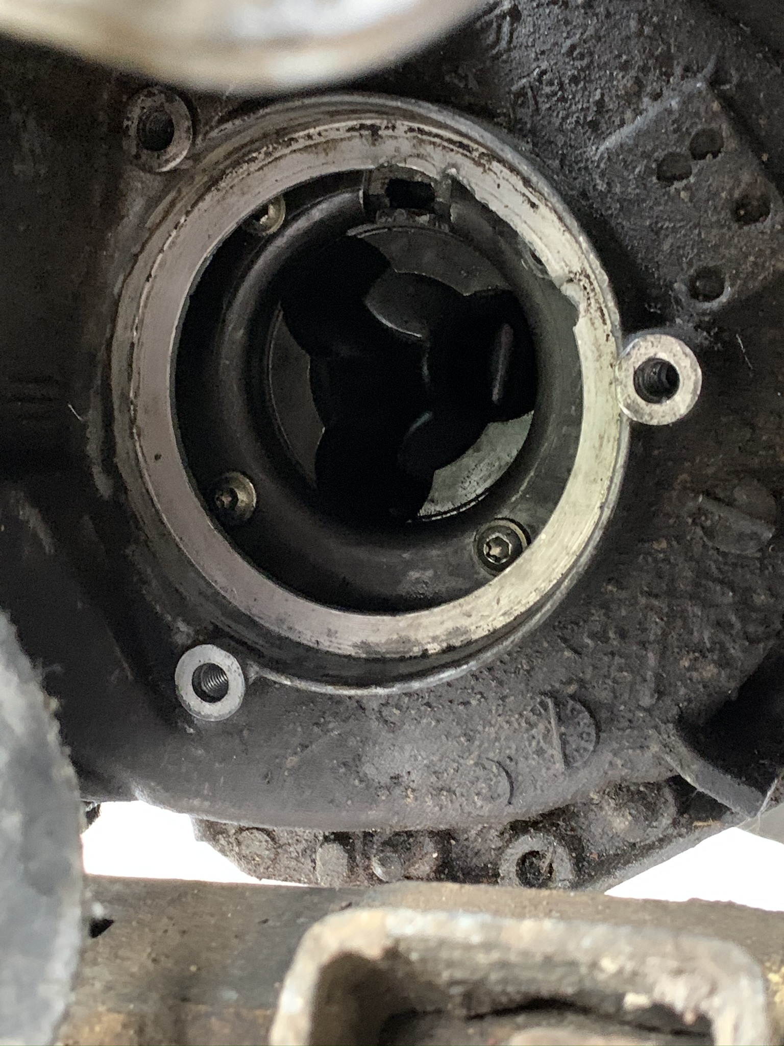

So the car was delivered home and the garage that took a quick look had put the assorted shaft part in the footwell.
So I’m missing one set of needle bearings and the cylinder bit.
I may drain and see what I can fish out to start with.
Drained the oil and found no needle bearings in the oil.
Took the shaft out.
I could feel the missing third circular lobe jammed just inside the gearbox casing, between the case and the bolt in plate.
Managed to get that out, although I can feel another piece.
Two questions:
Is the bolt in plate aftermarket, like Renfort, or original.
I’m surprised that no needle bearings came out with the oil. Not one. Any thoughts?
