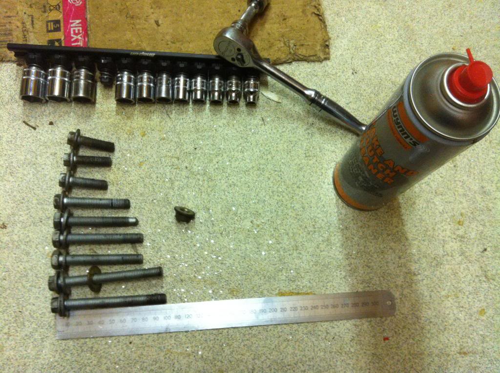

Gearbox bolts. Whats ones go where ?
Following on from this thread i have sourced bolts for my gearbox as my originals went astray.
http://www.cliosport.net/forum/show...earbox-Bellhousing-Bolts-What-sizes-do-i-need
My next question is.
What bolt goes where as i have a few of varying lengths.
Top 3 go in the bottom between sump/box.
The lowest 2 go in the very too of the bell housing
Next 3 up go in the starter
The last one I think goes just above the clutch fork
Cheers buddy
Do i have the correct amount of bolts ?
Just a quick tip for anyone reading this, considering taking out the gear box... They all fit around the bell housing in a rough circle.
Best thing you can do is use a piece of card and punch the bolts through in the position they come out. So you end up with something the looks like a clock face, but made of bolts.
My mate mentioned he did that with his RX8, bit late now though.
Saying that they went missing after a house move so i dunno if the cardboard would have helped :(
Does anyone know how many bolts i'm meant to have ?
Same as the others. Yes there should be 2 nuts
Ok cheers
When you say the others ? Do you mean the short ones at the top of the pic ?
I noticed one nut goes on a bolt/stud that sticks out the engine block on the left.
Where does the second nut go ?
Does it go onto one of the bolts in the pic ?
Possibly the one with coned/chamfered/radius end ?
Or does it go on another stud somewhere ?
And does the starter bolts assist in holding the bell housing on ?

That's as it came in to me, span them out and snapped the picture..
Guess that box had been off before then....
