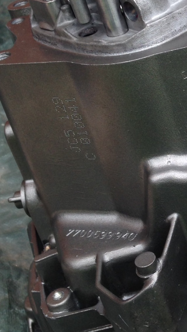

The code is stamped on the underside of the casing at the 5th gear end. It's in the front edge so easy to locate as the pic below shows.
