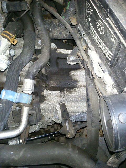

Had the airbox off today giving the tdc sensor and throttle body a quick clean. I noticed this under the airbox.
DSC_0552 by thepike1984, on Flickr

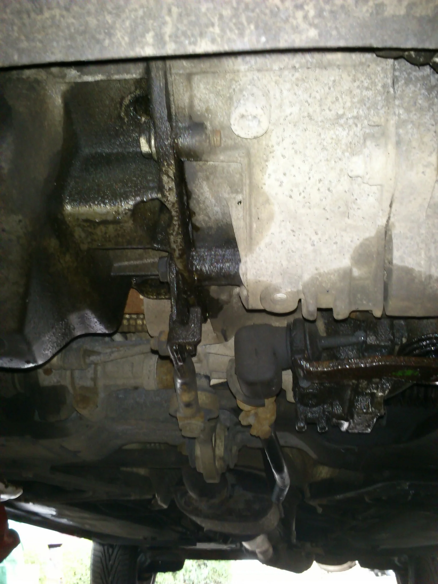

So I jacked the car up and had a look underneath, to find this.
DSC_0562 by thepike1984, on Flickr
I know a slight leak is normal but this looks rather excessive. Any ideas?

Top "leak" is just from the gearbox breather, not the end of the world entirely normal. Selector leak on the box is normal again.
The only "worrying" one is the leak from probably the crank main seal back of the flywheel, either that or the sump is leaking where it joins the no1 main cap. Its probably done that from new and in the grand scheme of things will be fine to leave. Major to sort it out.
