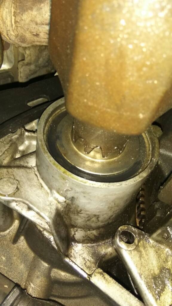

Hi,
Got a little leak from the gearbox, cleaned all the area and it seems to leak from here :
Any clue?
  Clio 172 RS ph1
they are 3 seals over there, wich one it leaking ? the big one ?
genuine renault isnt recommended ?
  330i. E30 Touring.
Yep, big one there.
They're not genuine renault, no. Doesn't matter too much - it's not a pressurised seal. Mine did a good few thousand miles without leaking..
  Clio f1 r27
Just bringing this back from the past, we’re can you get the metal ring that on the drive shaft in the picture above?
I have a J&R shaft but that ring isn’t present.
