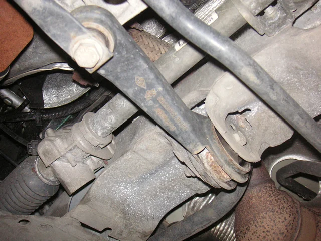

Lets just say im in gear 3 and I come sharply off the accelerator the gearstick would fling back like it wants to go into gear 4 by itself!

The dogbone mount holds the engine from moving forward and backwards. You cant miss it if you look under the car just behind the engine and gearbox.
  Renault Clio 1.5 DCI
You could also try removing the battery and see the state of the (upper) gearbox mount. If it is broken then the engine/gearbox could move alot.

gearstick moves too much when the dogbone mount is broken or it's rubber gone. Replace it first to see if will be any improve. Also check the mount under the battery and see if it's bolts tight.
Replacing the dogbone mount is a easy peasy job.
