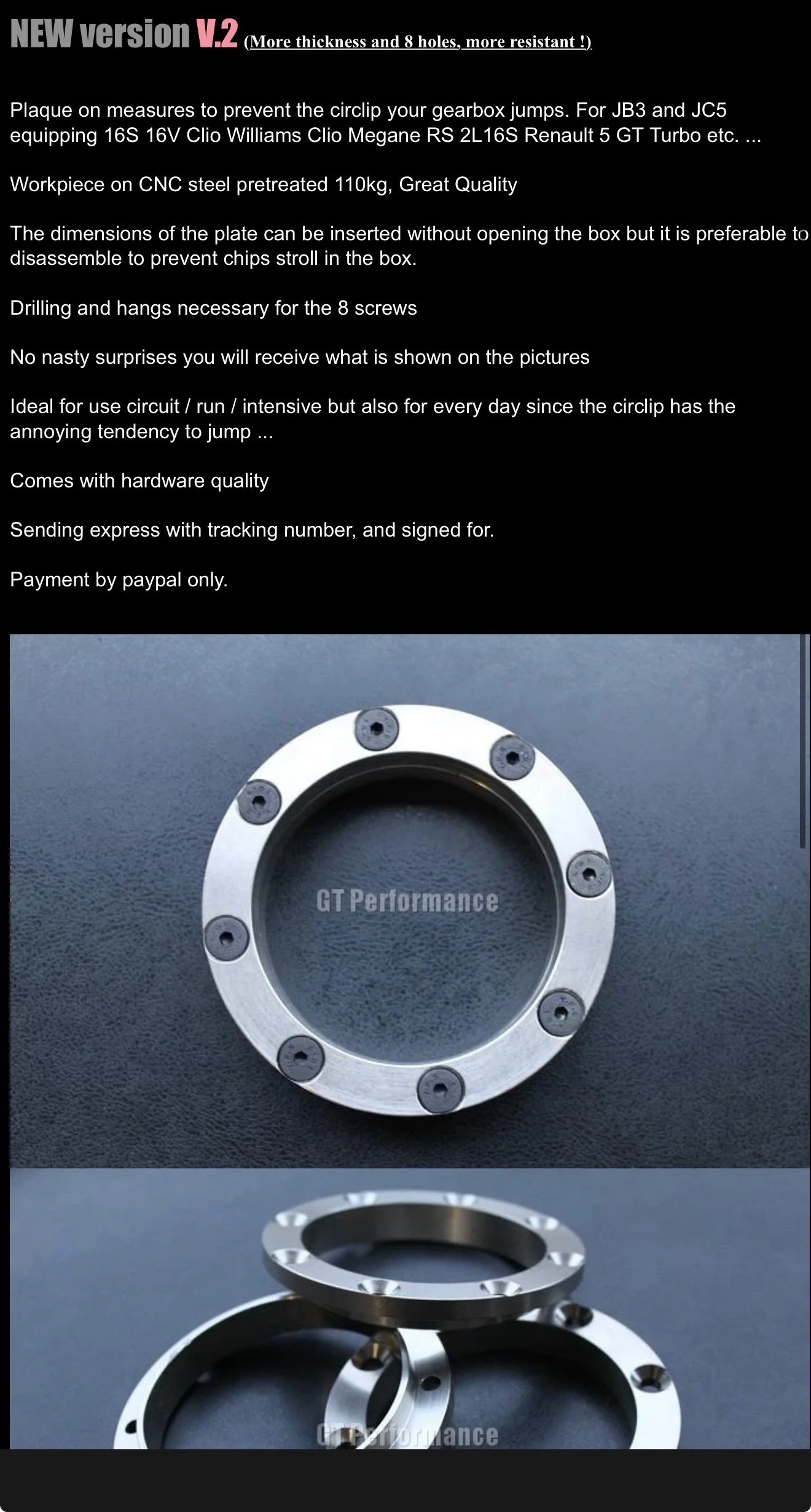

Im just wondering if anyone else has used the clio diff reinforcements, i own a 1.6L 16V k4M with a JB3 979 gearbox, i had this issue back in December when my dog bone mount snapped 🤦‍♂️. I fitted a second hand gearbox and thought the problem would be over!
Today the engine mount under the battery tray snapped and ive lost all gears again. Im guessing due to that circlip.
Ive ordered a reinforced plate but have no idea if it will fit my gearbox.
Any points would be appreciated,
Thank you for taking your time to read this!
A mate of mine ran this plate in his Clio 172 cup, he kept popping the circlip in the gearbox. In the end it popped out so often the casting was ruined
You will need to make sure you get all of the metal swarf out of the box when you drill and tap the holes
