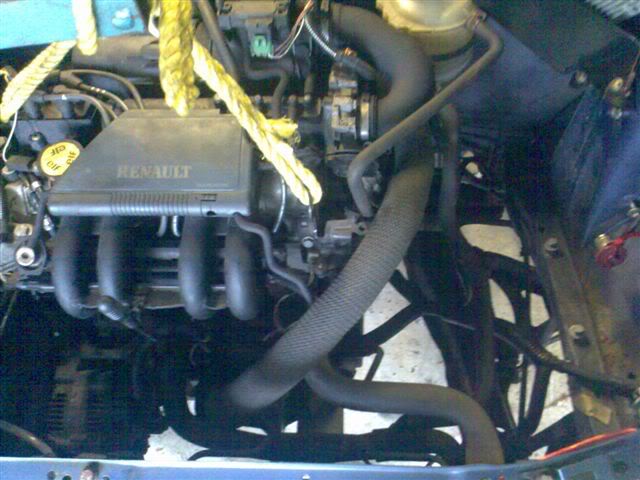

Cheers Dave, Managed to drop it out the bottom. Very tight though!
Had to lift the engine about 10 inches to get enough room to drop it out!
Easier to whip off the sub frame I suppose, but it looked very rusty and seized!
Empty Space!

Look at all the space in that engine bay! I wish my engine bay had that much space to work in!
