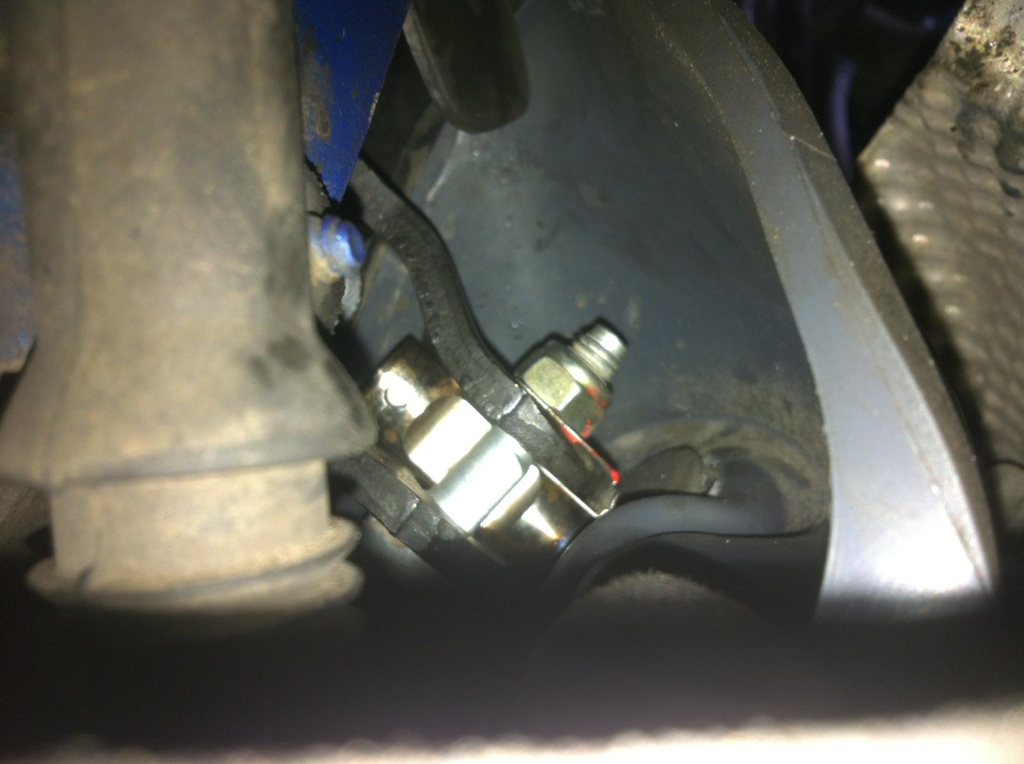

Anyway the last bit am struggling with is the steering rack pinch bolt... I cant remove it, None of my tools or spanners will fit on it and give enough room to loosen it. (13mm) and everyone that can get it must have small hands or something? haha.
Just want to make sure I have the right one ?
Is there an tricks or tips to getting it out, just about to give up on this for today :banghead:
Carefully angle the steering wheel and use a long extension bar, i found the angle can still be dodgy and it can slip, best to renew that with a new nyloc when replaced too.
