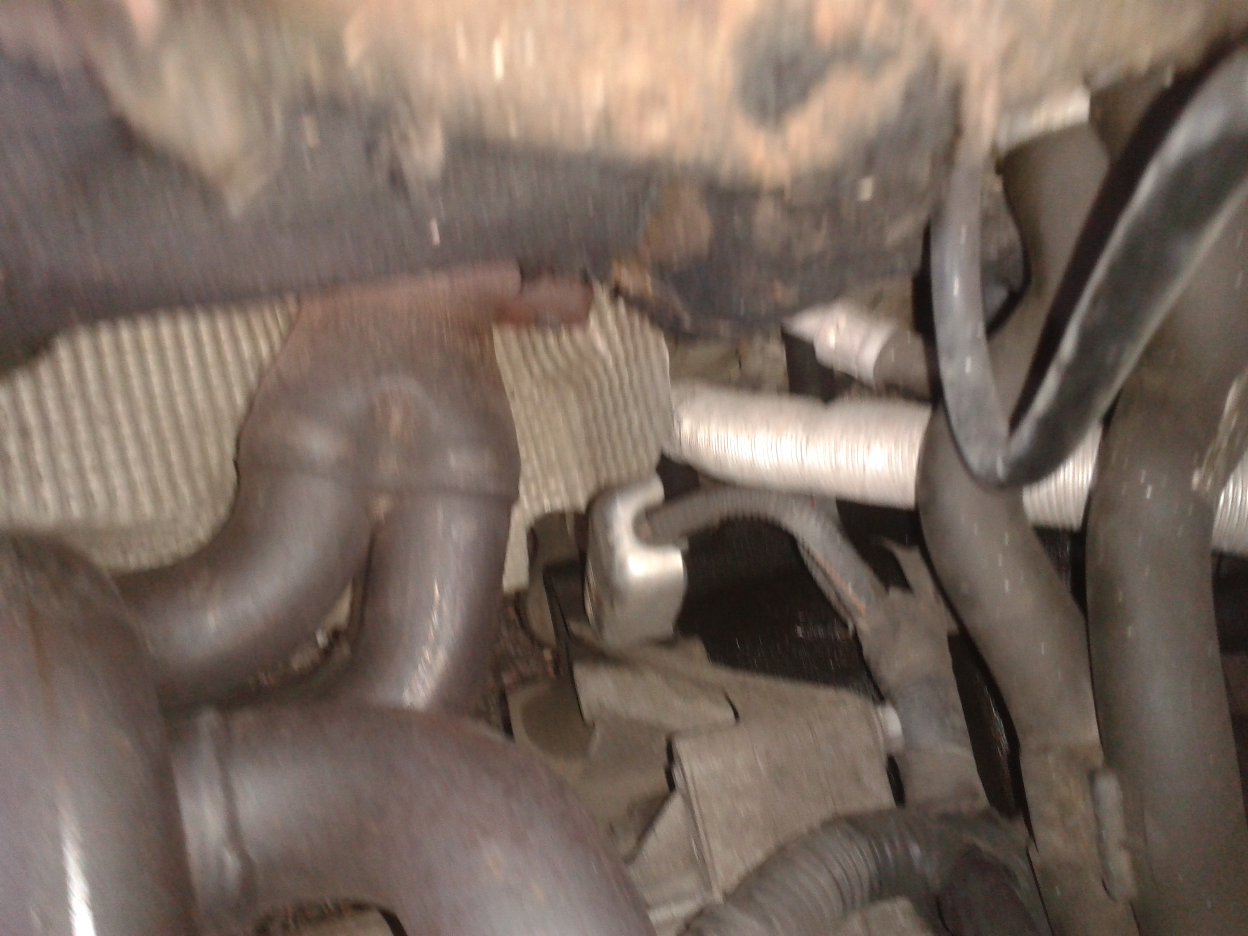

Whatever course of action you decide on, you need to check which box you have.
I suspect yours being 2003 will be a JC5-130 without a speedo drive, in which case you could also use a 129 or 089.
However if you have a 129 with speedo drive, that (or an 089) is what you are looking for.
I`m sorry to say that boxes do not come up for sale as often as they used to, so it would be best to obtain one before it becomes a necessity.
The speedo drive is clearly visible at the back of the box on a 129.
