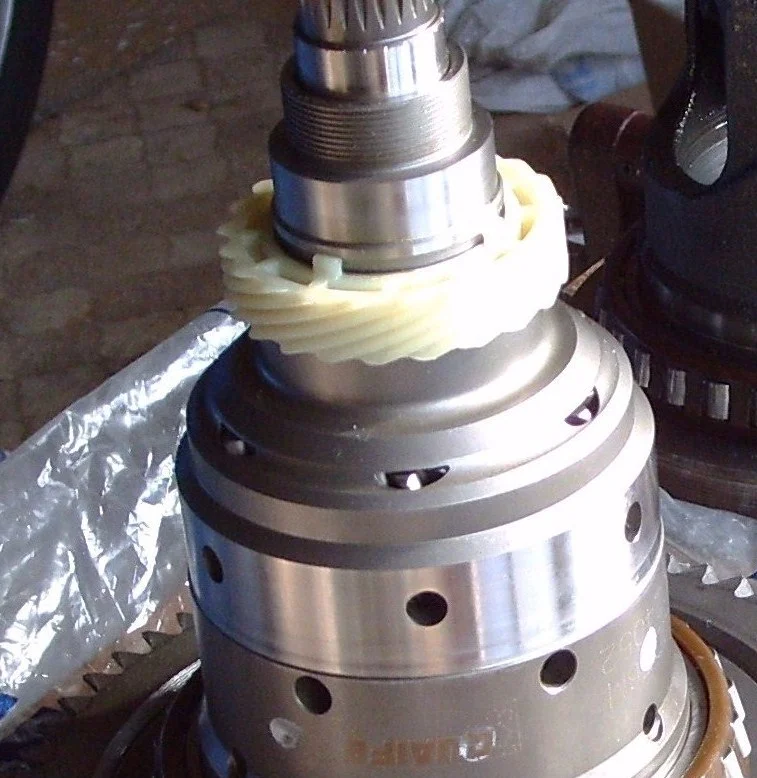

Sounds like the drive wheel for the speedo has fallen into the diff housing .
I am afraid it's a gearbox strip to fix . As the small drive wheel must go in place before the diff goes in.

  clio rs 2000
yes you are right activ
you have to take off the diff
and here you can see the speedo hole at the left top of the photo next tothe yellow synchromesh

cheers for the pics it helps me understand whats what, so does the speedo sensor mate with the white/yellow cox in the box?
