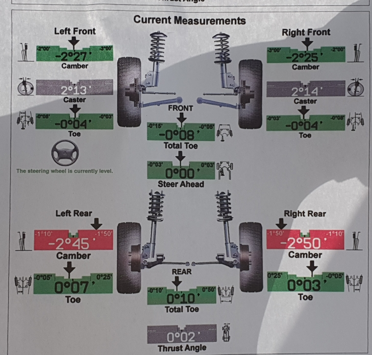

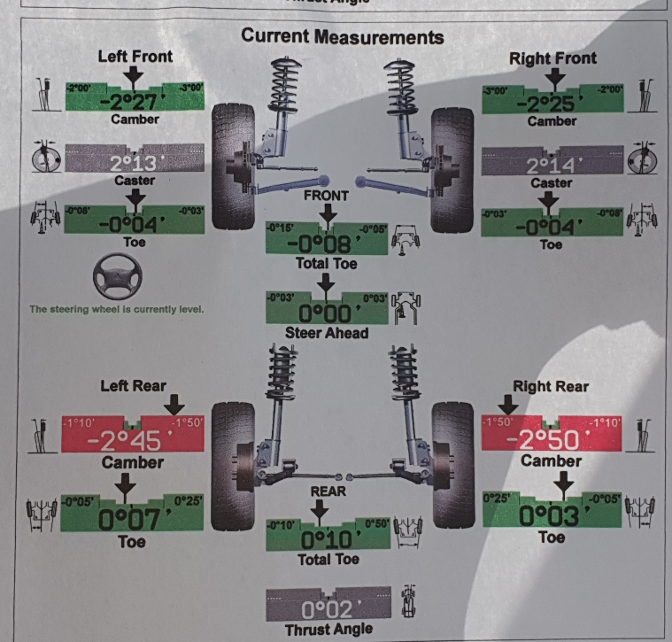

Mark fish setup the front end of mine to use -3.0 camber & 10 minutes front toe out, have been using that for a number of years and the car feels great. On the rear ive fitted a set of -1.0 shims which takes both my rears to -2.5, somehow my beam isnt bend as it seems quite normal for them to be abit out. I also drive to and from track, although usually fairly slowly as my car is horrible to drive on the road.
