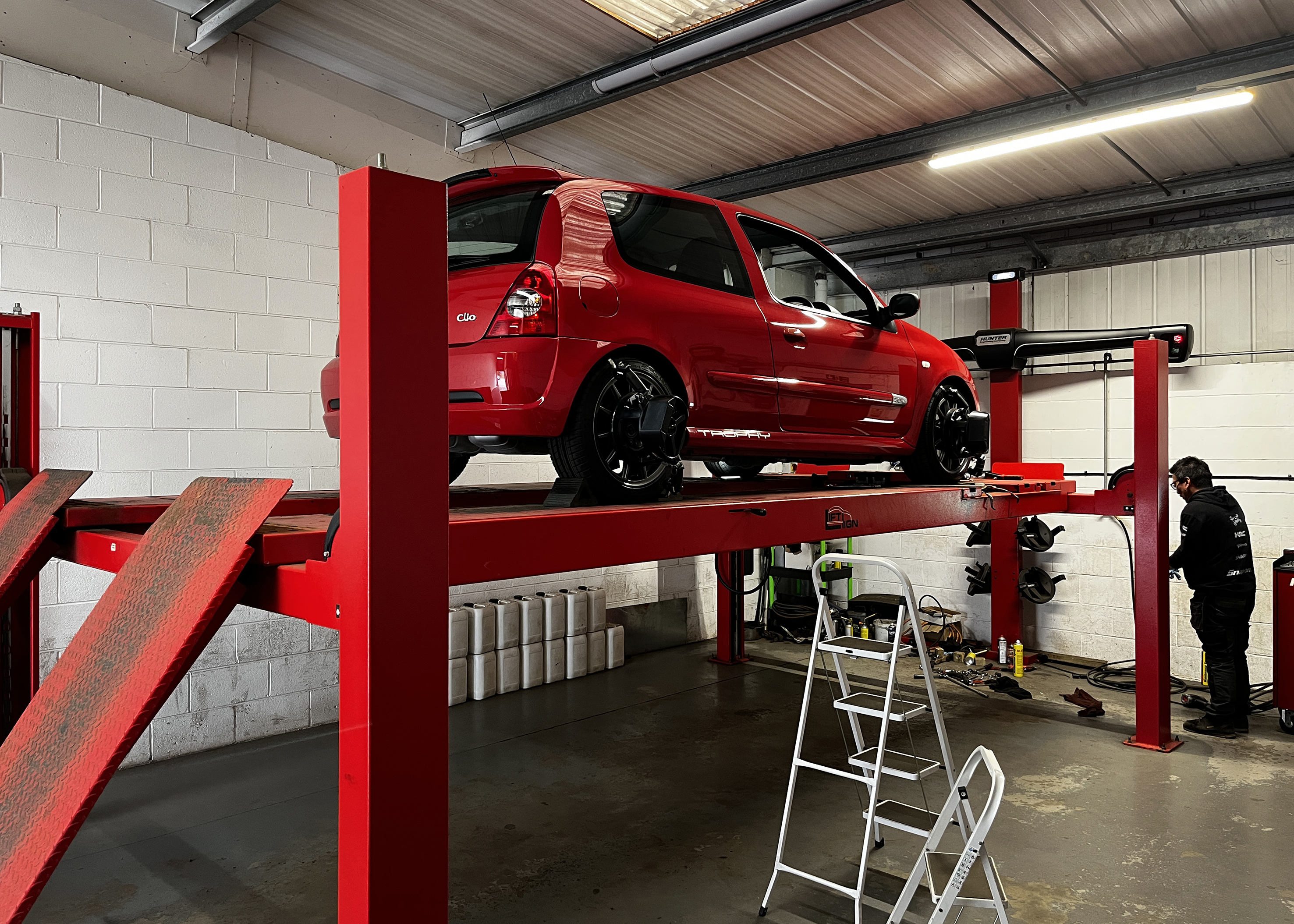

Hi all, I've just had a fair bit of suspension refresh work carried out on my 182 Trophy, however, I'm finding the way it's been set up on the front end really not to my taste, I'd go as far to say I preferred it before the work. I think it's a geometry issue, mainly the front toe setting, which to me feels like it's been set to toe in, which from previous experience I really dislike. I expected the specialist who did the work to set it up at least parallel, but it feels off to me, it also irks me greatly that the steering wheel is now also off by a few degrees on the straight ahead. A good few years ago I used to have a 182 Cup which I had set up with a smudge of toe-out on the front which I liked the feel of.
I think I need to get the Trophy re-checked over / set up and was wondering if anyone had any recommendations? I'm based in Yorkshire, but am also happy to travel to the NW or even Mids of the right place/folk to get it right..

Where abouts in Yorkshire are you? Chong at ATEC-ALIGN is the best I've found. He is based in Huddersfield. About £60 for camber and toe adjustment last time I went which is pretty reasonable.
If you dont have camber bolts I'd buy some before going and get him to install them.

I'm about 40mins from Huddersfield so this could be good. I checked out the website, and it appears they literally just do alignment works which I took to be a good sign. Now I just need to decide whether to keep to a completely standard set up or put in some extra camber & toe out which is what I'm tempted to do. It would be great to at least get the steering wheel running straight at the very least! 👍

Chong is fantastic and will sort you out with anything you need. Just give him a call and talk about your requirements! Worth the drive at only 40mins.
Hes the only guy I've been to who managed to get the wheel perfectly straight. Even allows you to check it before its final.

Just wanted to say cheers for this recommendation, went to see Chong today. Great guy and he got the issues sorted. Brilliant!
