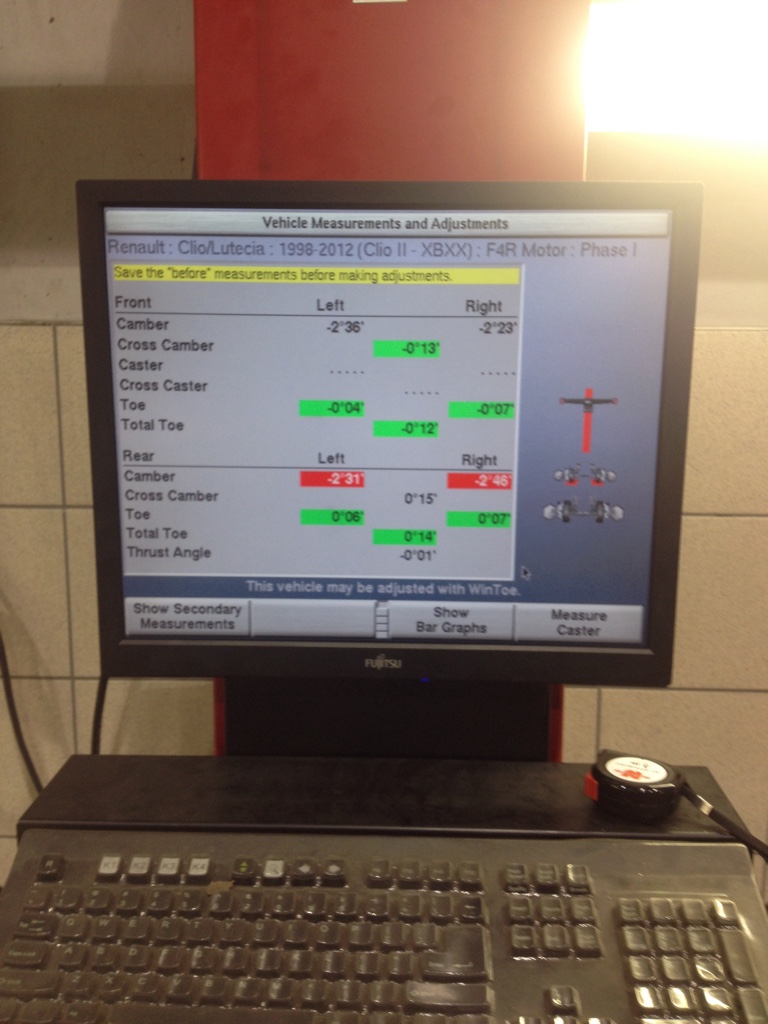

Cheers James, will get the bolts ordered and fitted then get it down to Kwik-Fit and request the above front settings on their Hunter Hawk.
Just to clarify James is it -1.5-2 degrees both sides so -3-4 or -1.5-2 degrees total? Same with the toe out is 12 minutes either side or total?
JamesBryan
i've got -1.5 degrees camber each side and 12 minutes total toe out.
If it's a full on track weapon, then you'll want -2 or -3 degrees camber, but you can only get so much with the bolts.
JamesBryan
Brill, cheers bud. Presume the rear can stay as is until I get coils?
They're roughly -1.5 deg on the rear as standard or it will be when lowered on coilovers, mine is.
Only way to add camber on the rear is shims behind the stub axle but -1.5-2 degrees is enough.
Toe in on the rear as standard so keep it like that or have it parallel (will need shims to do that too), but don't have toe out.

I run -2.5 deg up front with 20mm spacers and same at the rear with 10mm PMS block spacers . Behaves perfectly fine on track on F1s.
Saying that I also run Roll centre kit and it turns in epic . I'm leaving it at that .
I now have a set of ET40 Pro 1.2s so I now have 16mm spacers up front and will be reducing the width of the spacer at the back to suit.
