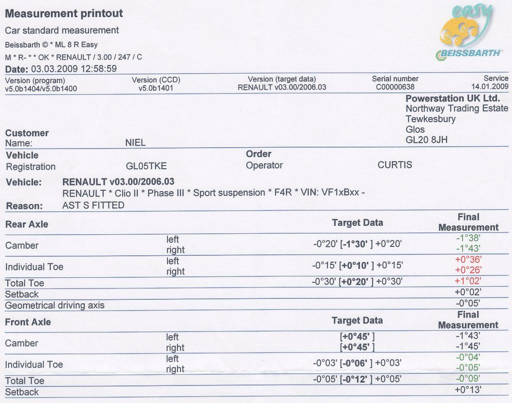

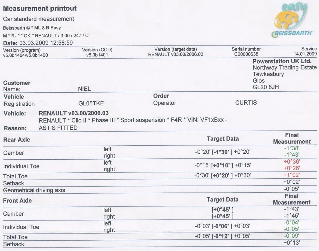

Hopefully you'll get more, but here's mine from AST:
No idea really, I'm by no means knowledgeable in setting up suspension. I'd ask Curtis at Powerstation if it wasn't for the fact that I like the way it feels.
Your question is valid though, I'll ask Mark Fish his opinion next time I'm there to satisfy curiosity.
