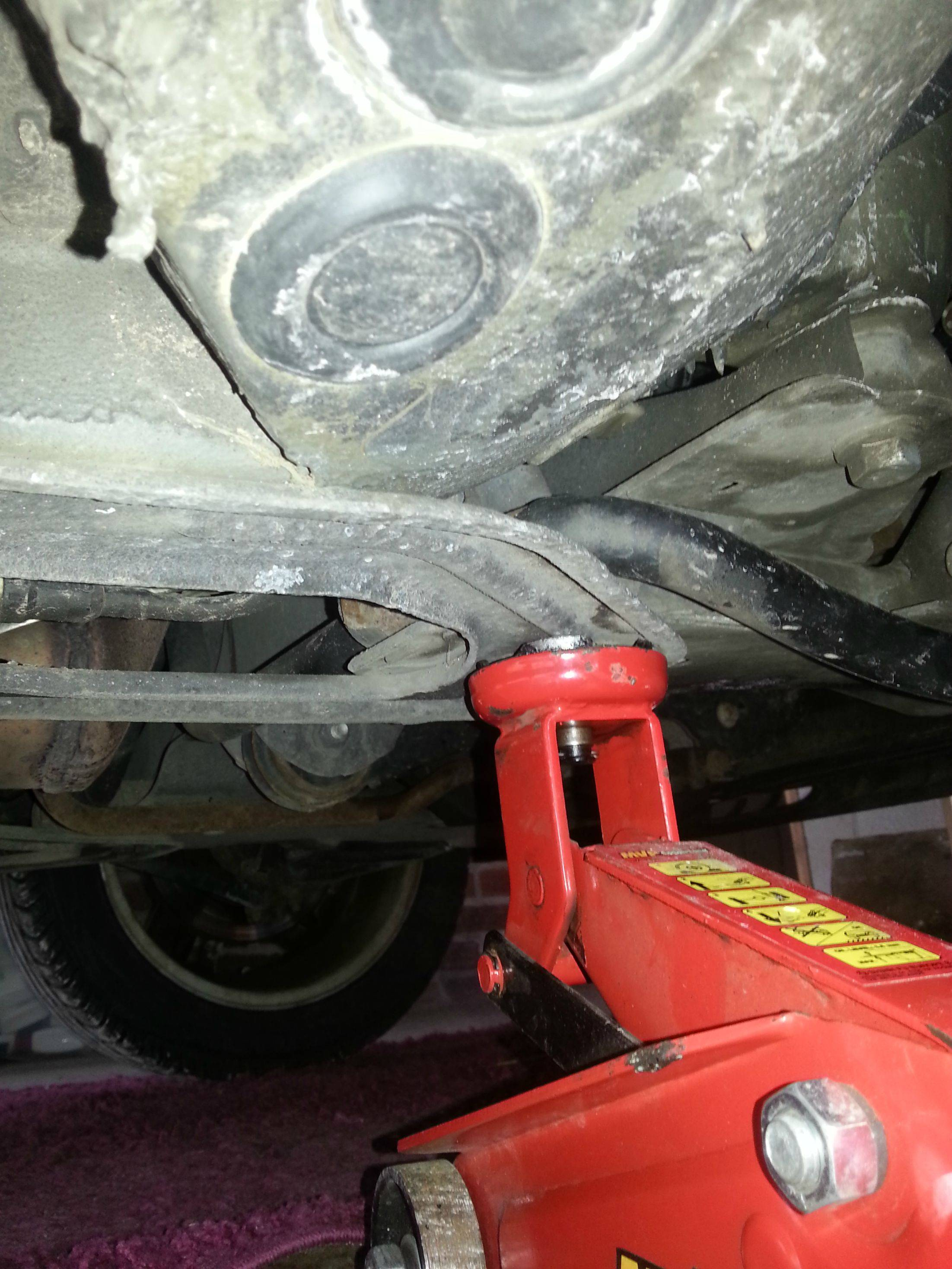

Touring_Rob
Image stolen from another post. I just drive up onto a couple of blocks then jack from here:
