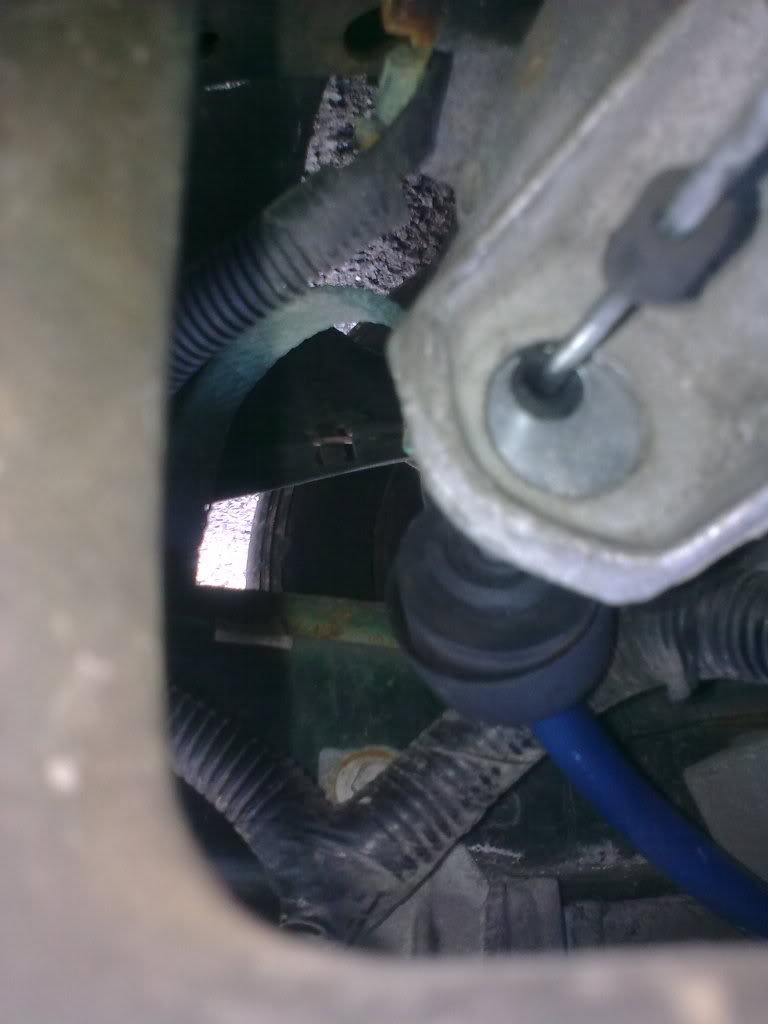

I get to my mates work place and within 5mins i can clearly see the clutch cable has failed and there is sod all wrong with the clutch pedal!! I drive off with the intention of going to buy a clutch cable, quite frankly a bit pi**ed off ive wasted the morning in a scrap yard. Whilst driving an idea pops into my head and i decide to try something before buying the clutch cable..

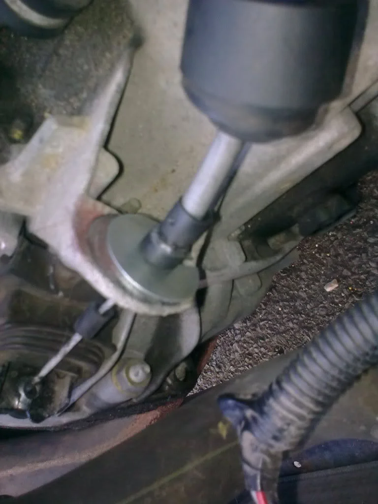

A suitable washer and 30seconds with an angle grinder later the car drives fine!!
Its clearly bodged but for a car not worth £150 im happy with what ive achieved :)
