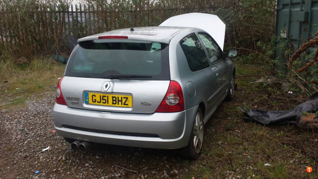

After a year away from my 172 cup I decided it was time to get myself a toy. After a few weeks of searching I put a cheeky low bid on a 51 plate 172 and to my surprise I won.
I picked the car up a few days ago and she was in a sorry state to say the least, it had been parked under a tree for God knows how long there was enough water inside to take my fish for a drive and it smelt like a tramps ball bag, even with all this I saw the potential in the old girl there was history from a previous owner adding up to around 4 grand so at one point she was cared for

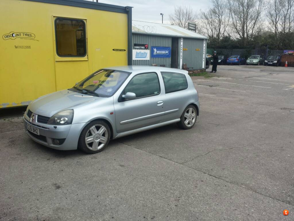

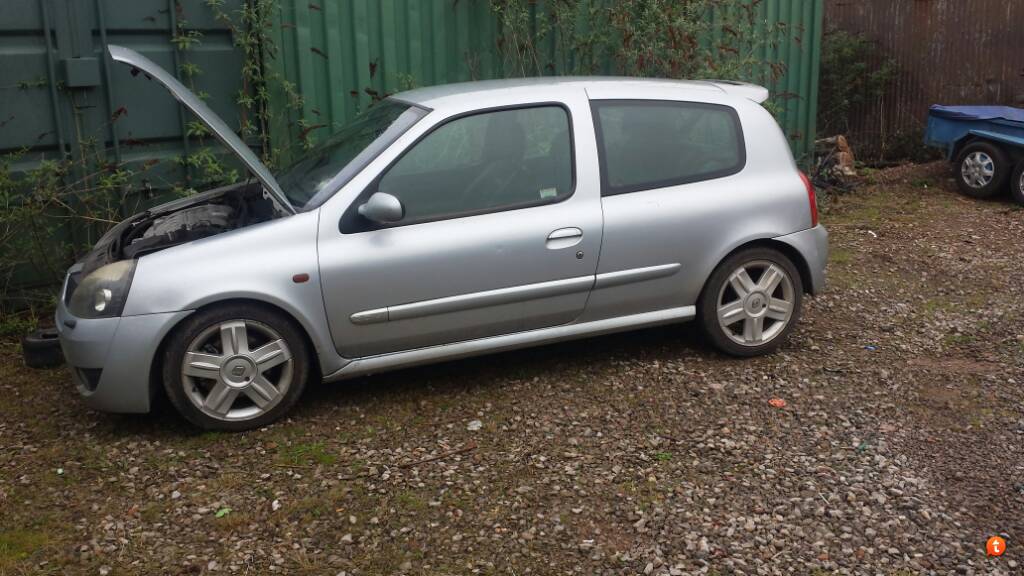

the next morning I took a few pics
On the whole the body was good unfortunately that's the only positive.

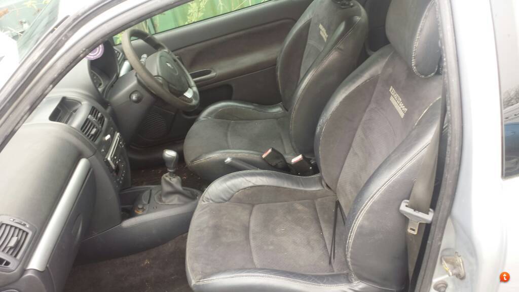

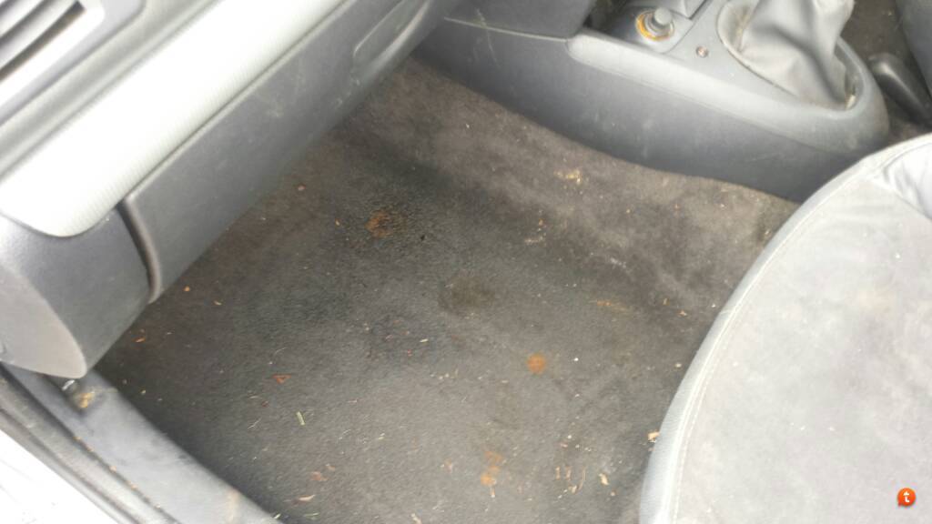

The interior was abysmal

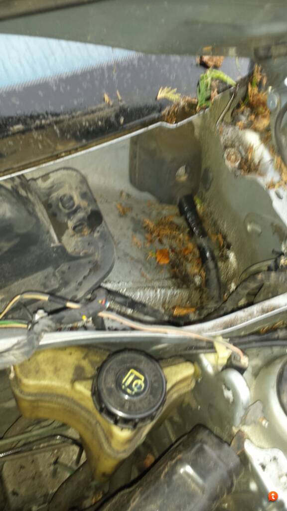

I set about finding the cause of the lake under the seats

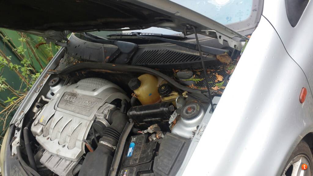

On removing the scuttle and a few other bits I found this
I'm sure there was half a tree down there it took an age to get it all out.
I then decided to gut the interior after removing the carpet the smell from the sponge was unbearable it stank of rotten egg so it got binned and I mopped up the rest of the water. My apprentice then spent the day cleaning the inside and after a gallon of big orange the car now smells citrus fresh.

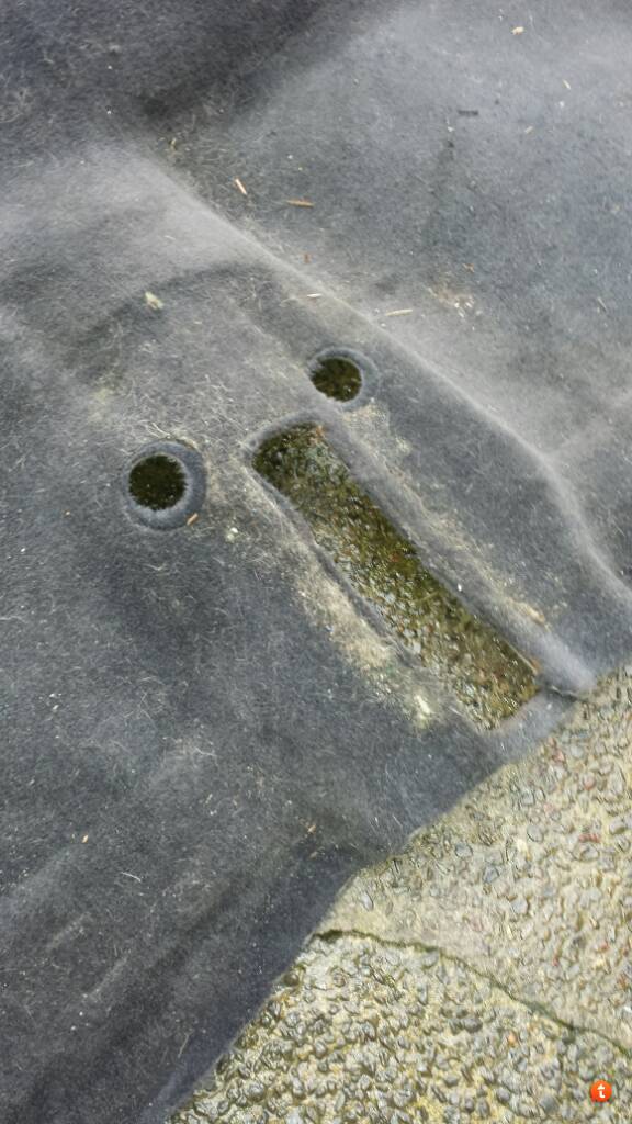

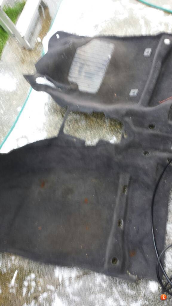

Today I decided to dust off the pressure washer and have a go at sorting the carpets
Before
After 3 washes and alot of scrubbing they came up well.
