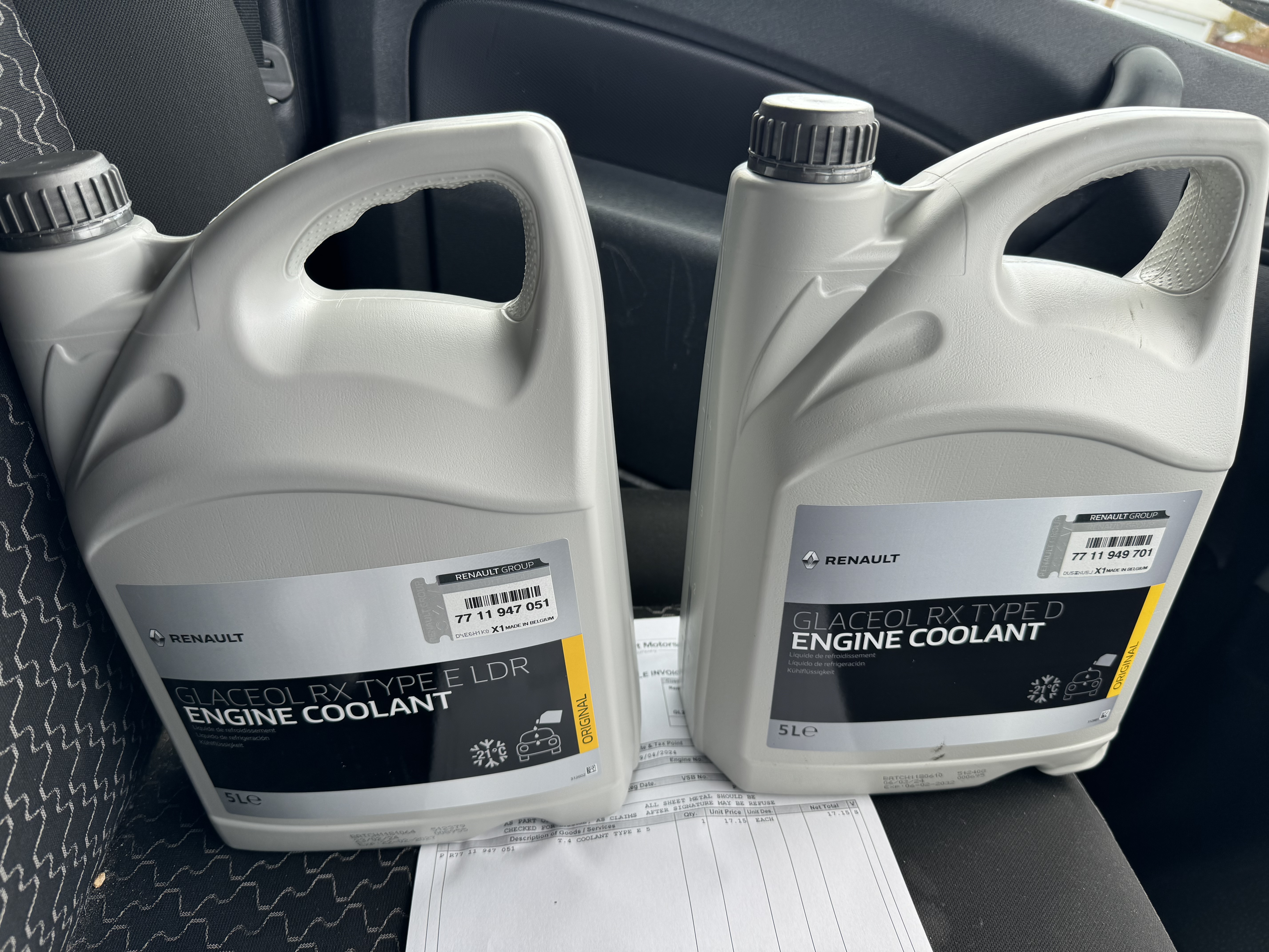

Glaceol RX Type E LDR Blue coolant sent by mistake or genuinely the right stuff?
R3k1355
So are Renault discontinuing Type D, but maybe Febi are actually producing it and will continue to sell it under their own name?

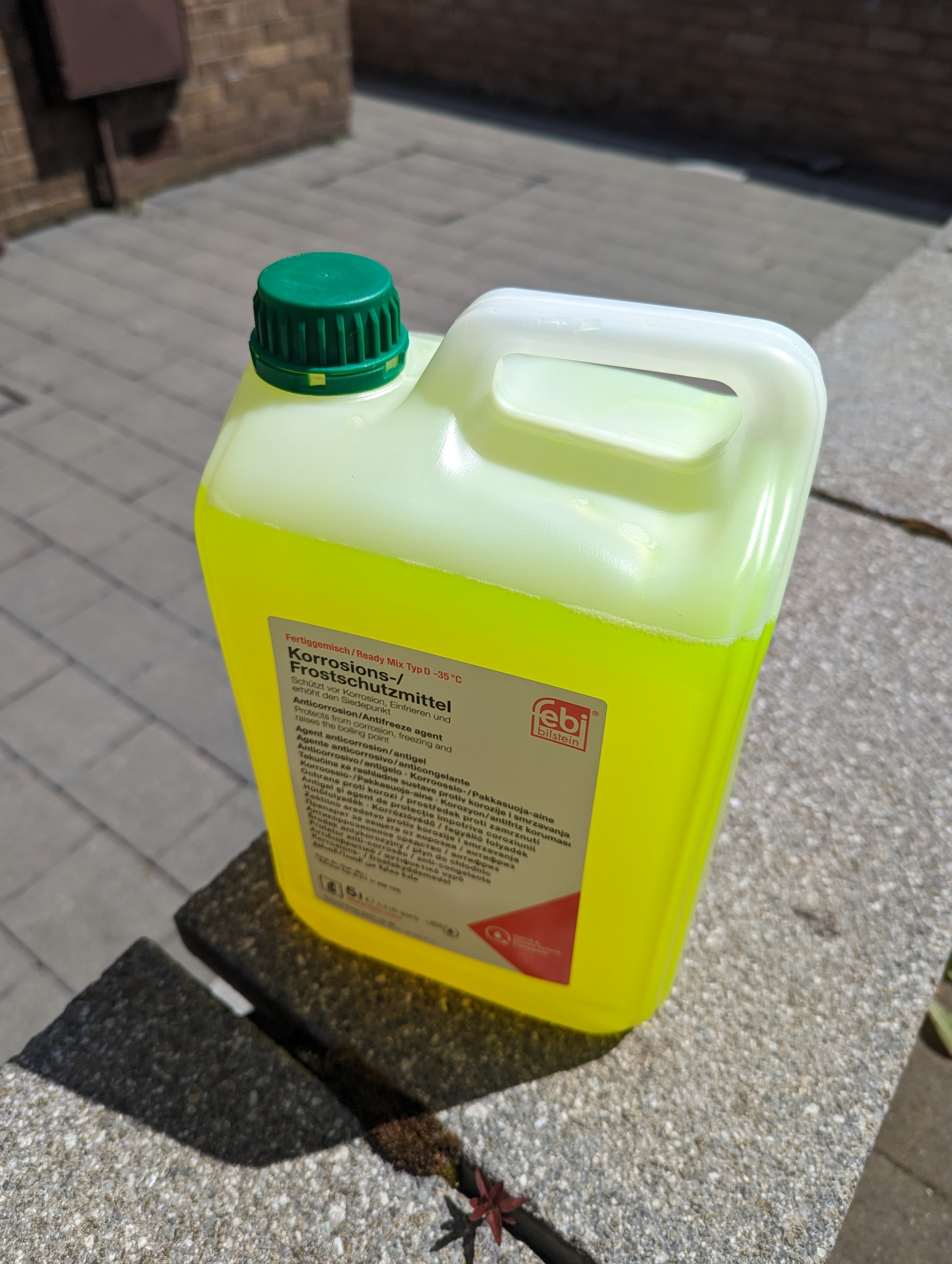

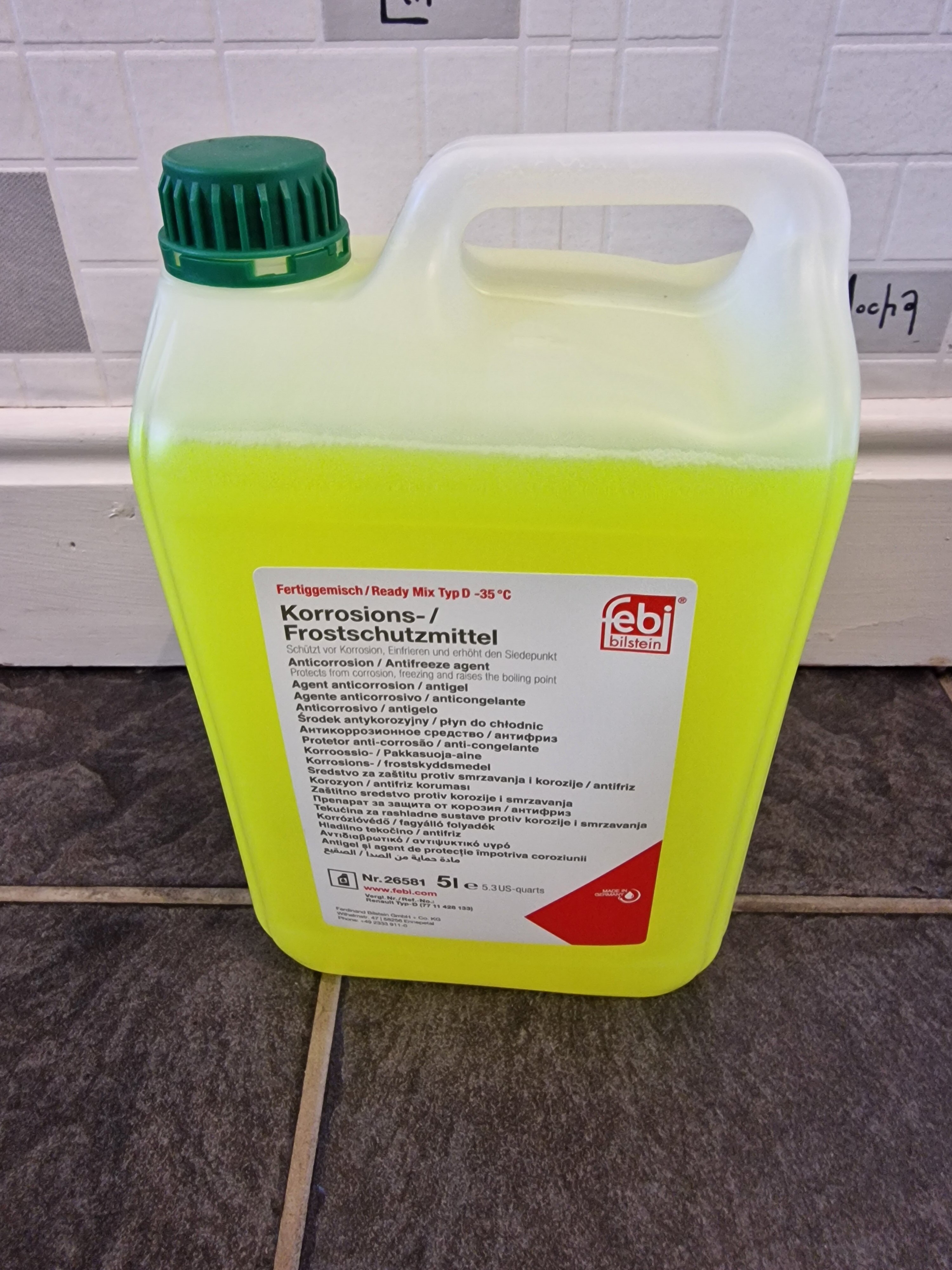

Febi type d arrived. Colour looks correct, id be suprised if it isnt the same stuff in a different container.
Only one way to be sure Jon 😂

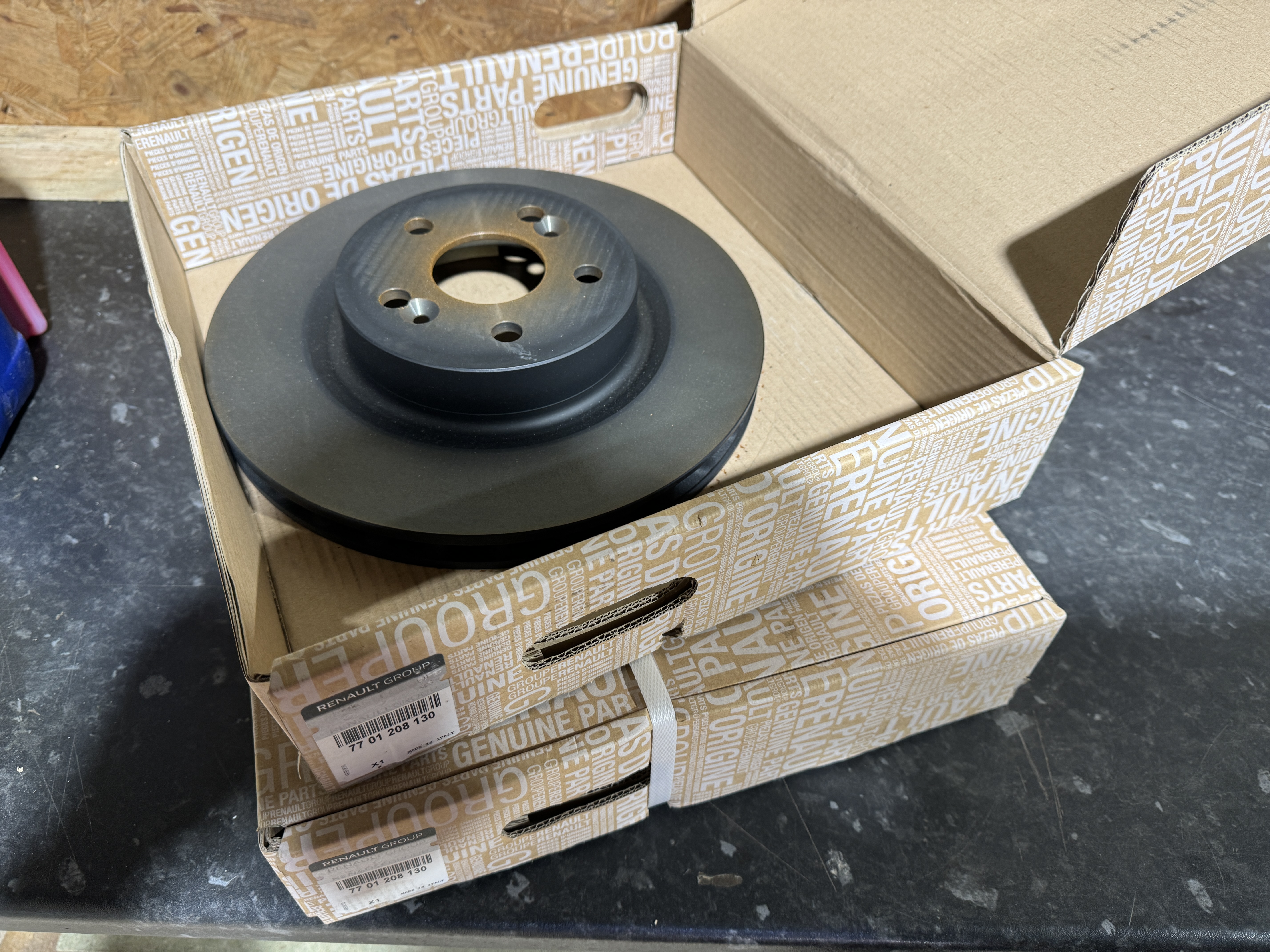

I got a new set of Renault 197 front discs for under £100 including the Vat and they are still sitting boxes from Aug 2022

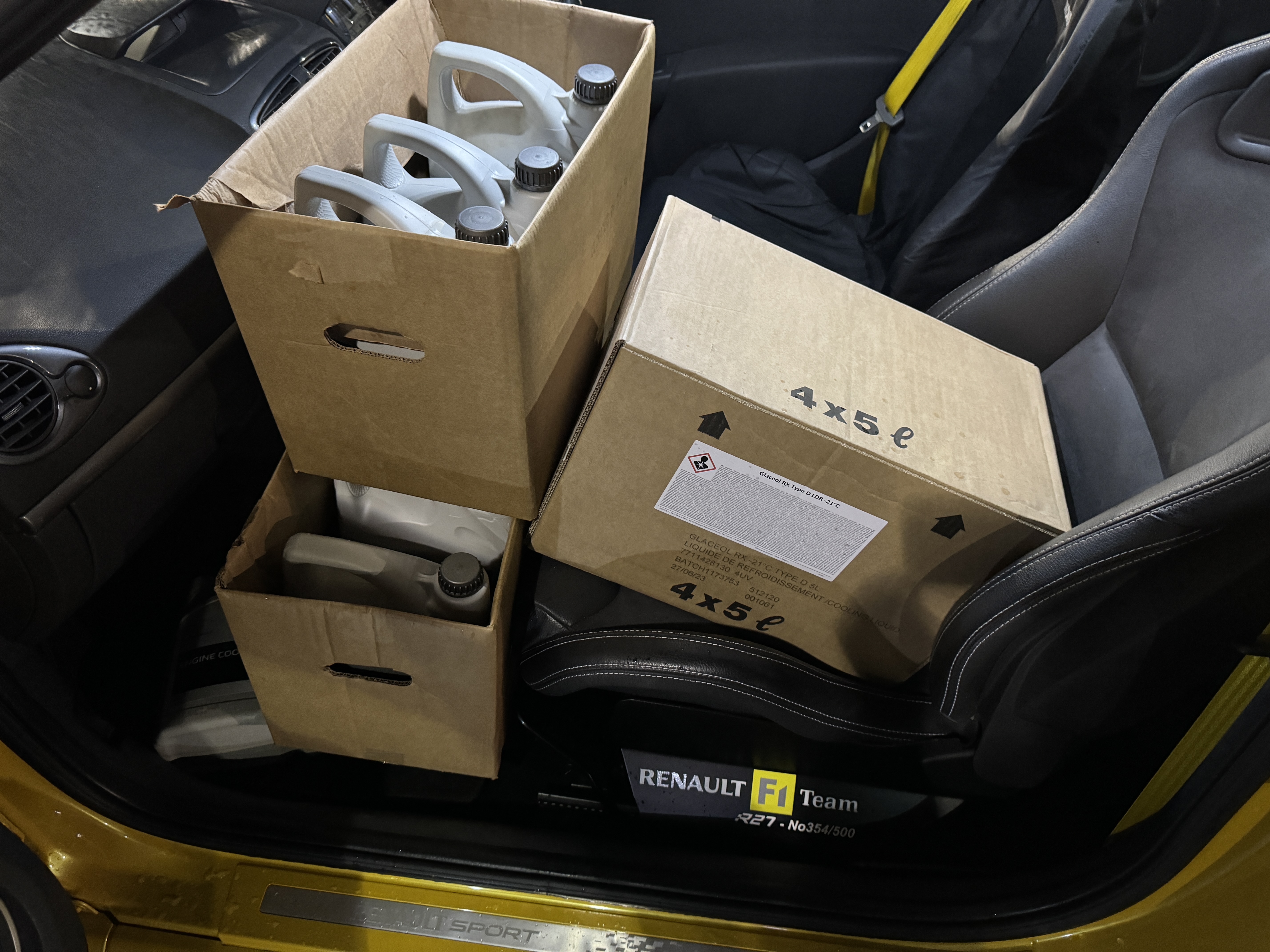

That’s me up to 20 bottles all with EXP 2031 apart from one at 2028.
@Martin_172 if you need a bottle I’m not 100 miles away 👍🏻

F@cking 20 bottles 😄 are you okay? Thats like Renault doomsday prepping.

Having the same issue here RPD sent me RX TYPE D the other week and didn’t realise just how much I’d get through bleeding the system. By time I ordered more and paid postage it’s the same as my local dealer but they only have RX TYPE E now and from what I can make of it all and seem to be the same outcome as what you lot have come too that Renault say they can be mixed. So I will go ahead and see what happens and keep it updated

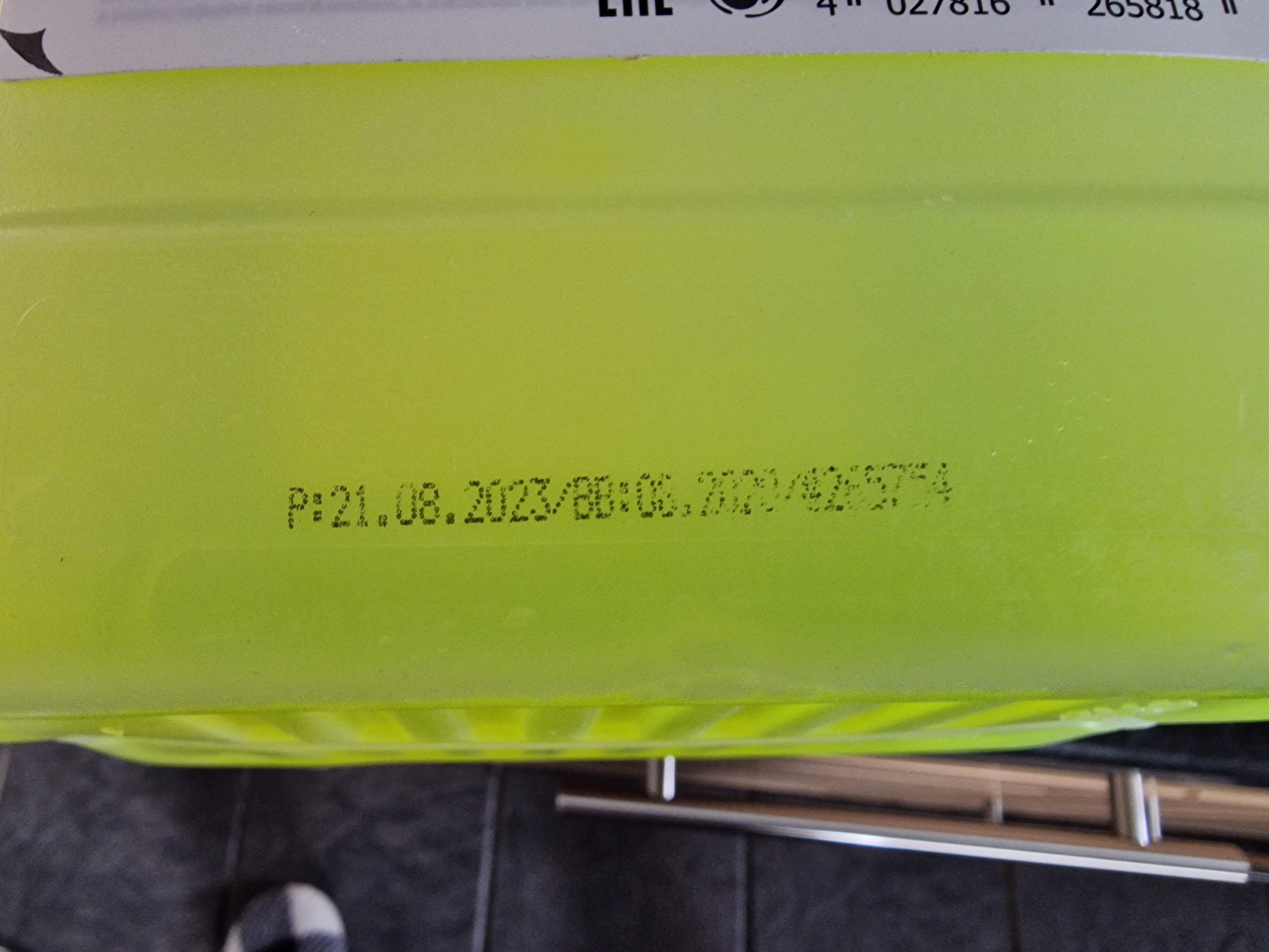

The thing that concerns me is. Type E has an expiry date of only 3 years. Whereas Type D is 8 years.
Surely the Type E will degrade much faster after going through 100s of heating and cooling cycles?

Antifreeze concentration test should be done with every service to give you an idea on concentration and change it every 3-5 years so wouldnt be concerned with that

I was looking at all my coolant and it all is the correct Type D coolant with EXP 2031
Now up too 27 bottles and already sold 4 .
I will just stick with the Type D until 2031

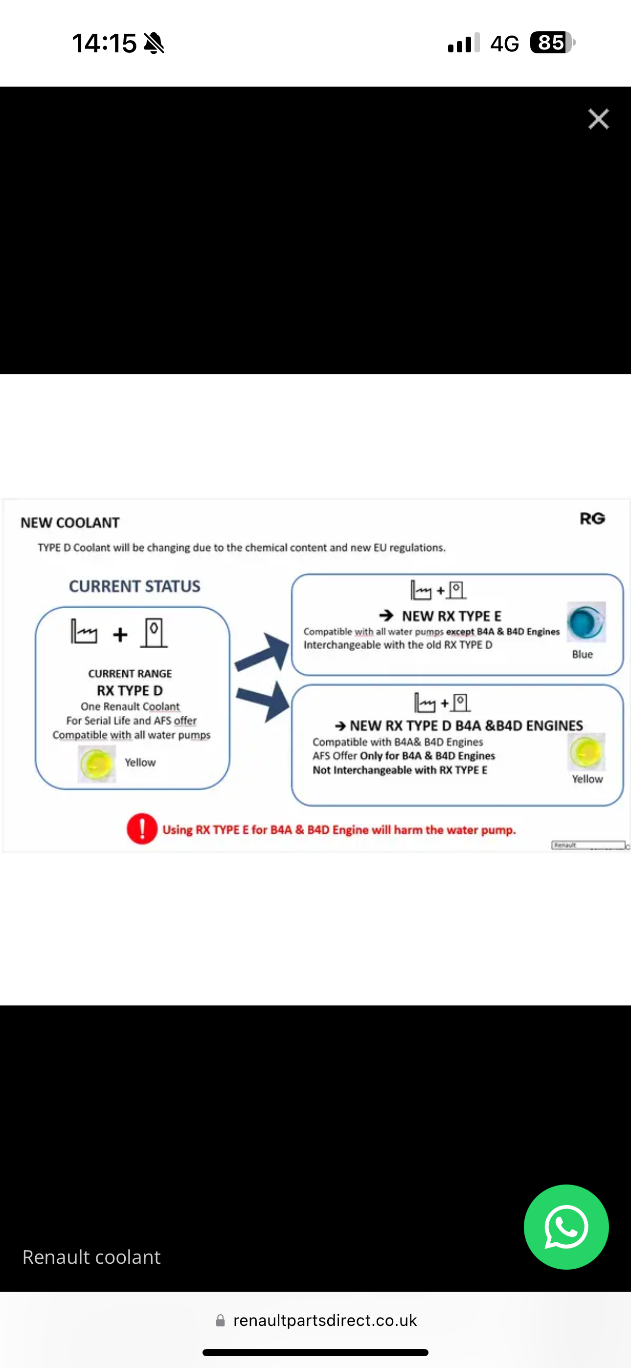

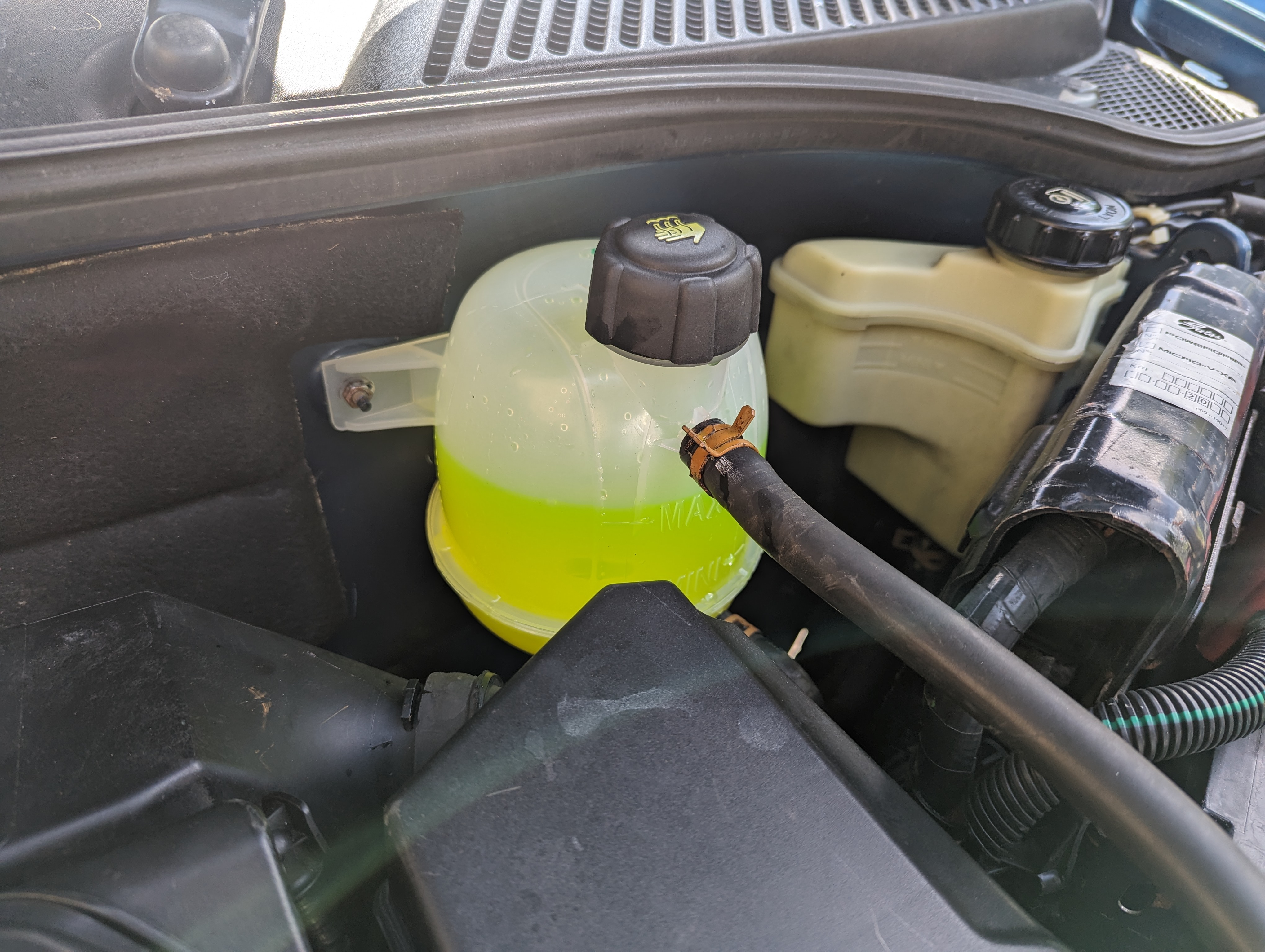

Renault released an engine in Mexico and needs a coolant that wont damage its water pump - this they have named (new) Type D
The product for all normal European engines is now Type E.
It gets a new Blue colour but the Renault notification they've sent to dealers says New Type E mixable with the Old Type D.
I'm going to guess that EU regulations have changed and they have to put a different blend of chemicals in but I've never had the free time to compare the bottles.
Theres no need to ship Type E back as its perfectly fine for your engine and theres no need to flush the old coolant completely out your coolant system. You will just get Green coolant when it mixes :D
