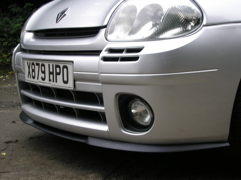

Skoda Fabia splitter is £12quid and made out of bendy rubber plastic, it needs to be screwed in with self tapping screws,
and then the ends cut off to tidy it up as it's a bit longer than a Clio, but it works.
Skoda part number : 5J0 807 061 9B9
Massive thread on it here.
http://www.cliosport.net/forum/show...-Fabia)&highlight=possible+new+splitter+found
If you type in Skoda splitter into the search bar, there's loads of thread on it with pics.

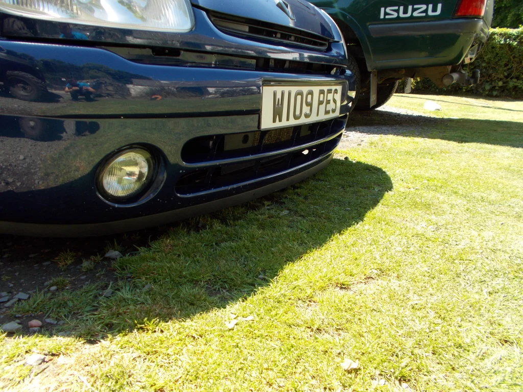

I fitted a ph2 splitter to mine, looked great IMO
