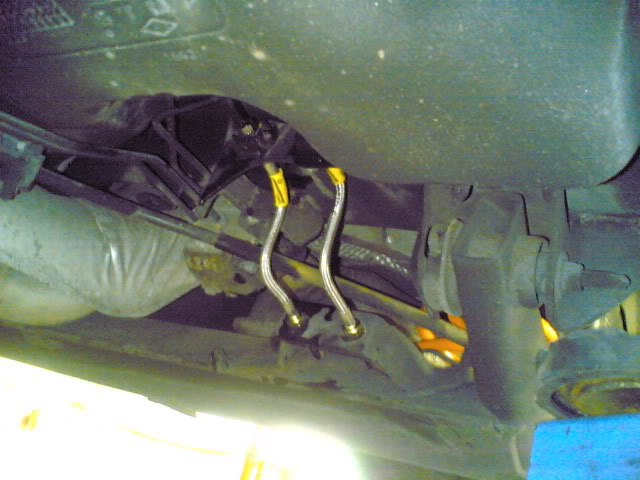

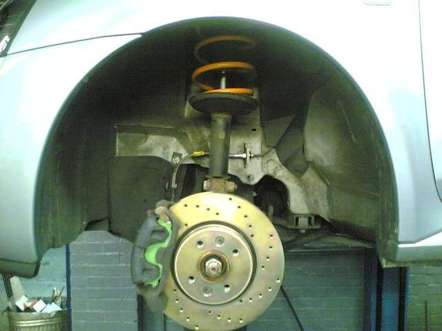

the clever people at Goodridge have decided to supply the wrong lines for the 172/182 clios, i will post pictures, but be warned they DO NOT fit (maybe a dodgy batch or someone had an "off day") 3 sets i've had now, all the same, still arguing the toss with them now :rolleyes:
front lines are approx 6inches too long
rear lines are different lengths, one is approx 3 inch too long and the other 4inch too long plus the have the wrong fittings

the front lines should be identical in length and so should the rears

Mine didnt fit without dye grinding the bracket holes. The unions were way to big!

Aye I thought they must be but the lengths were spot on, if anything I could do with another 40mm or so on the fronts.

they originally sent the old Clio 16v lines which are indeed as Fred says to long and wrong fixings, I have the correct ones in stock so don't worry.
I didn't get them from Ktec , I got them from one of my suppliers.

Tried to fit mine yesterday and as someone mentioned above the only way I can see them fitting is by grinding the brackets.

Should look like this (I hope!):
