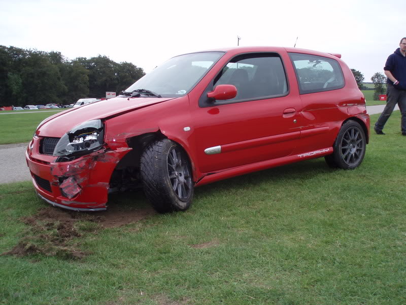

I had F1 assys on the back of my 182 when I started tracking it, couldn't do more than three or four laps before they started to melt. Made the back end feel very loose and unpredictable, the whole car would squirm around on the brakes. Great road tyres but my experience was that they were too soft for the track, and that was as a total noob.

Think I will look for some cheap wheels and get some good track day tyres.
I did quite a few track days a few years ago in a stripped out mk2 golf on toyo's and they lasted well.
