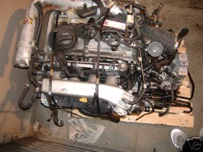

Yes it the vag lump, BAM code 225bhp standard.
As to the Trumpets as I have Alpha bodies I had a nitemare getting some of any decent lenght, got 90mm ones on it.
Paid £880 including delivery for the engine and box as it is in the picture.
I thought it was a bit of a bargain for that.
Be a while before I fit it, but then again its easter weekend soon hehe.
Should have done that in the first place.. Just stick it on the Emerald with a good intercooler, should be 280bhp or stick a IHI VF34 and 440's and tweek it to 320bhp all with std internals....
