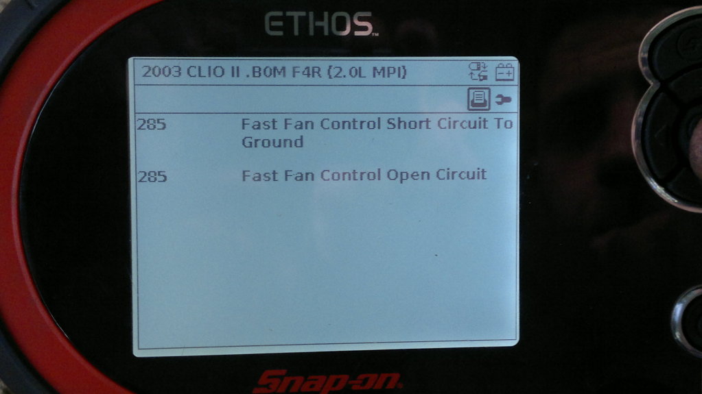

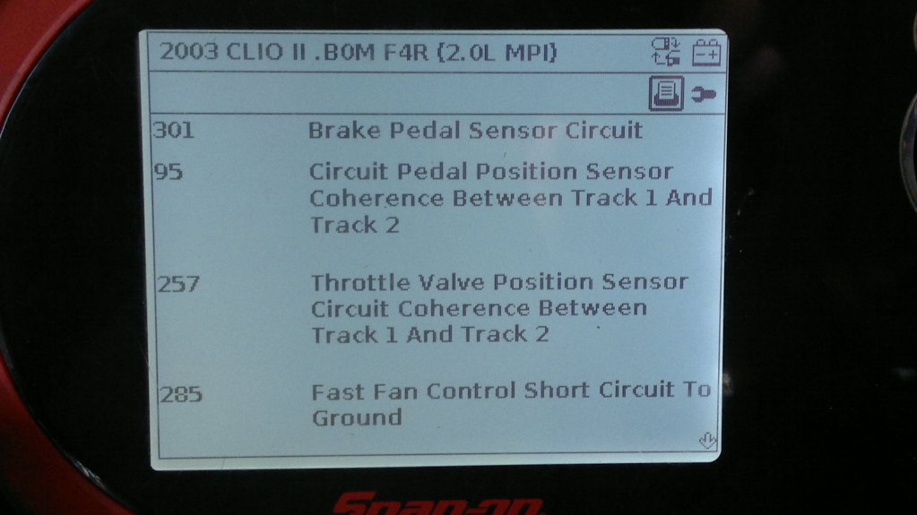

Got my ECU codes read,
Can anyone say what they mean?

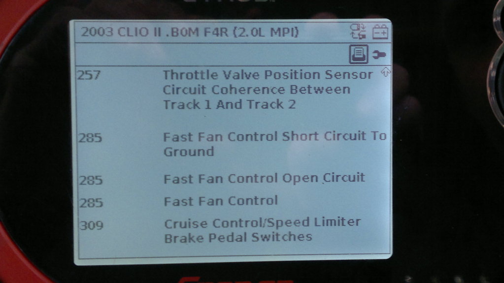

And some more on this screen
Cleared the faults and these were left -
When you cleared the codes did you switch the car off then on then drive it for about half an hour until its fully warm then read again? To check if any of the codes flare back up bar the fast fan one
throttle body's buggered IMO. Might be the loom (stronger possibility than usual as it's all been messed about with)
