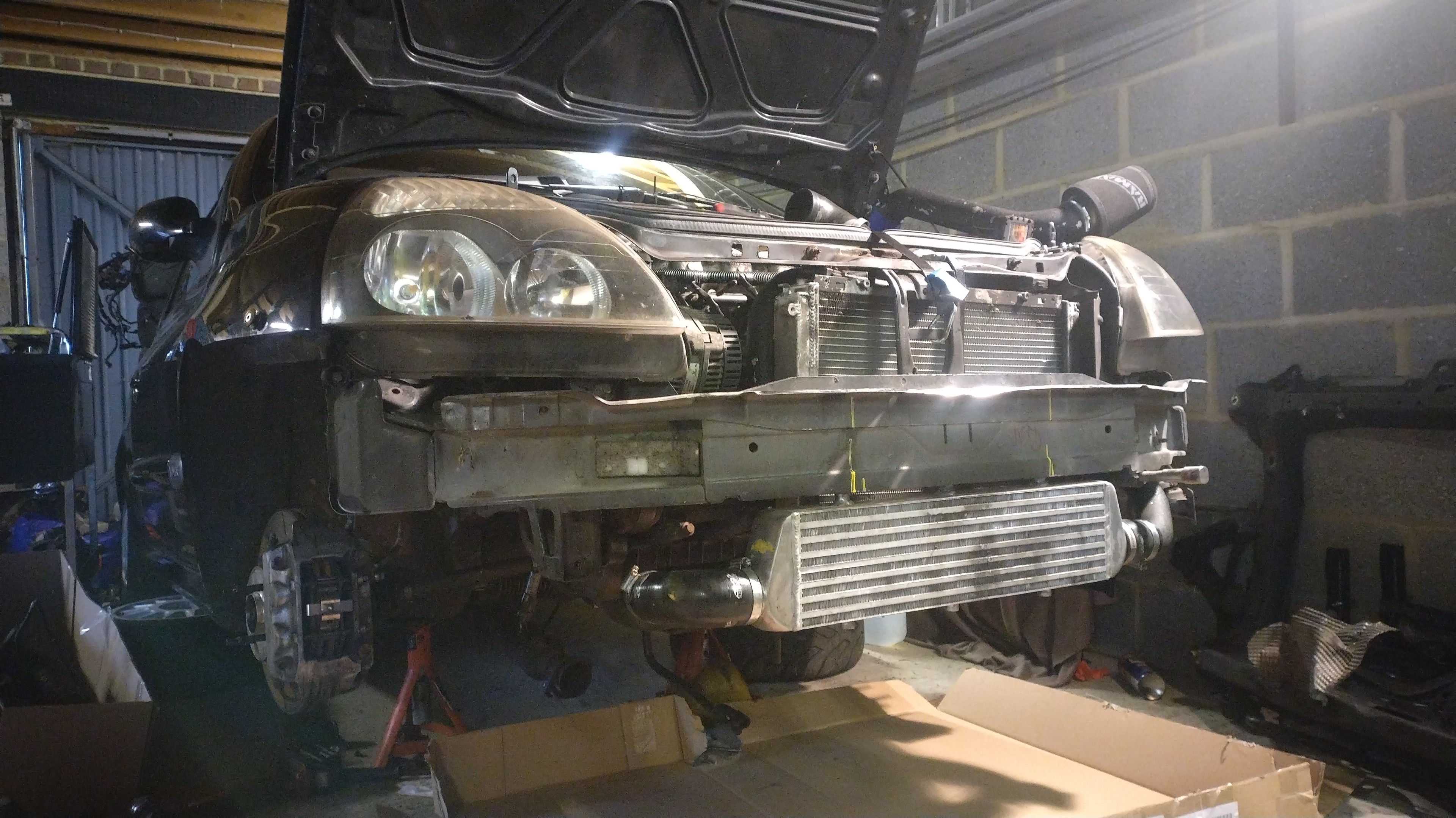

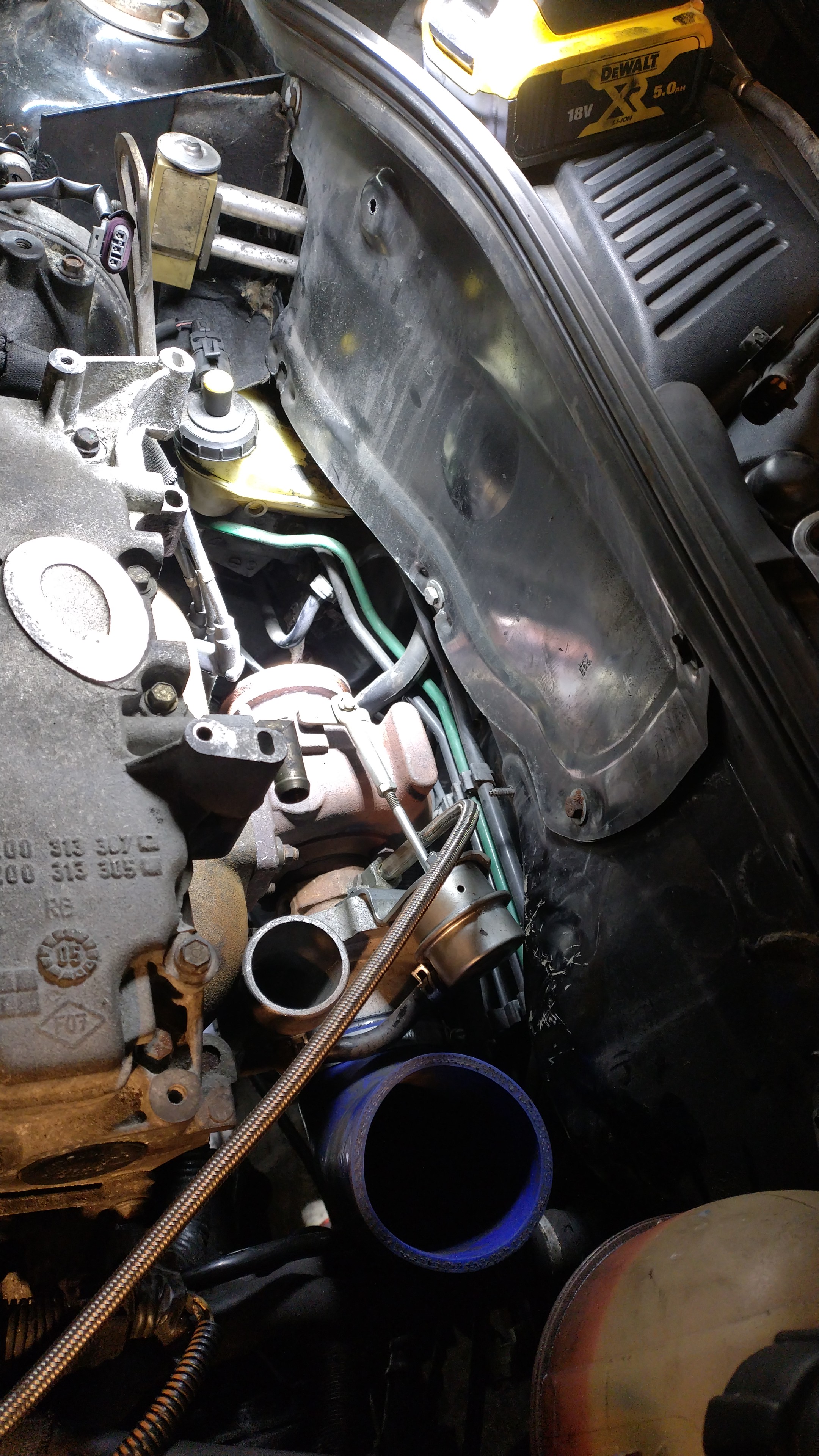

Good evening, I'm in the process of turboing the track car ,
I was running the group N timing and mapped ECU (tool and virginized ECU up for sale soon) but we need abit more on the track.

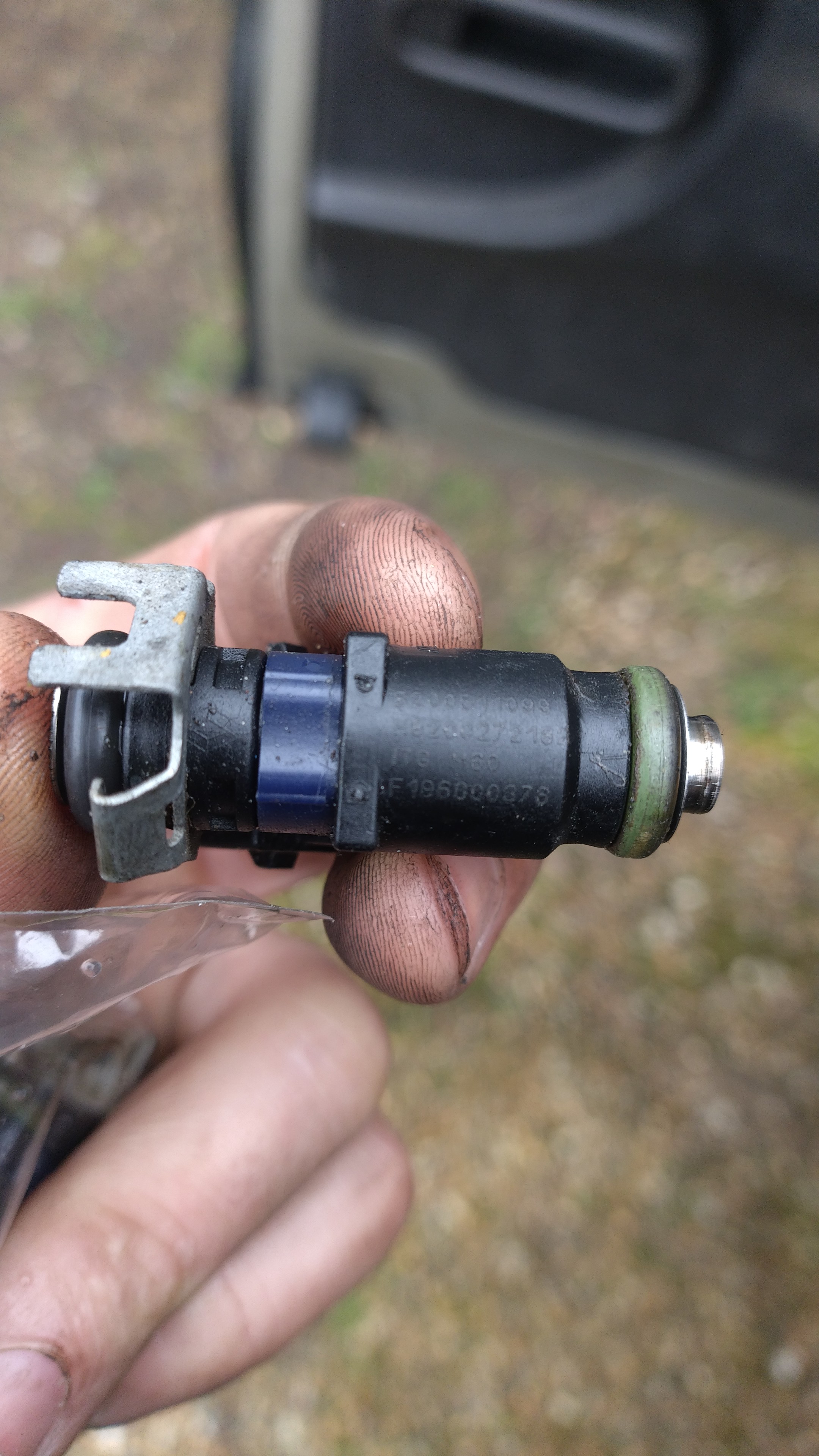

Mechanically the car is done, however I need the base map from an engine dynamics conversation to run the megane 225 injectors and the map sensor voltage clamp . I'd like to get the car driving and do abit of road tuning myself before I book it for a rolling road .

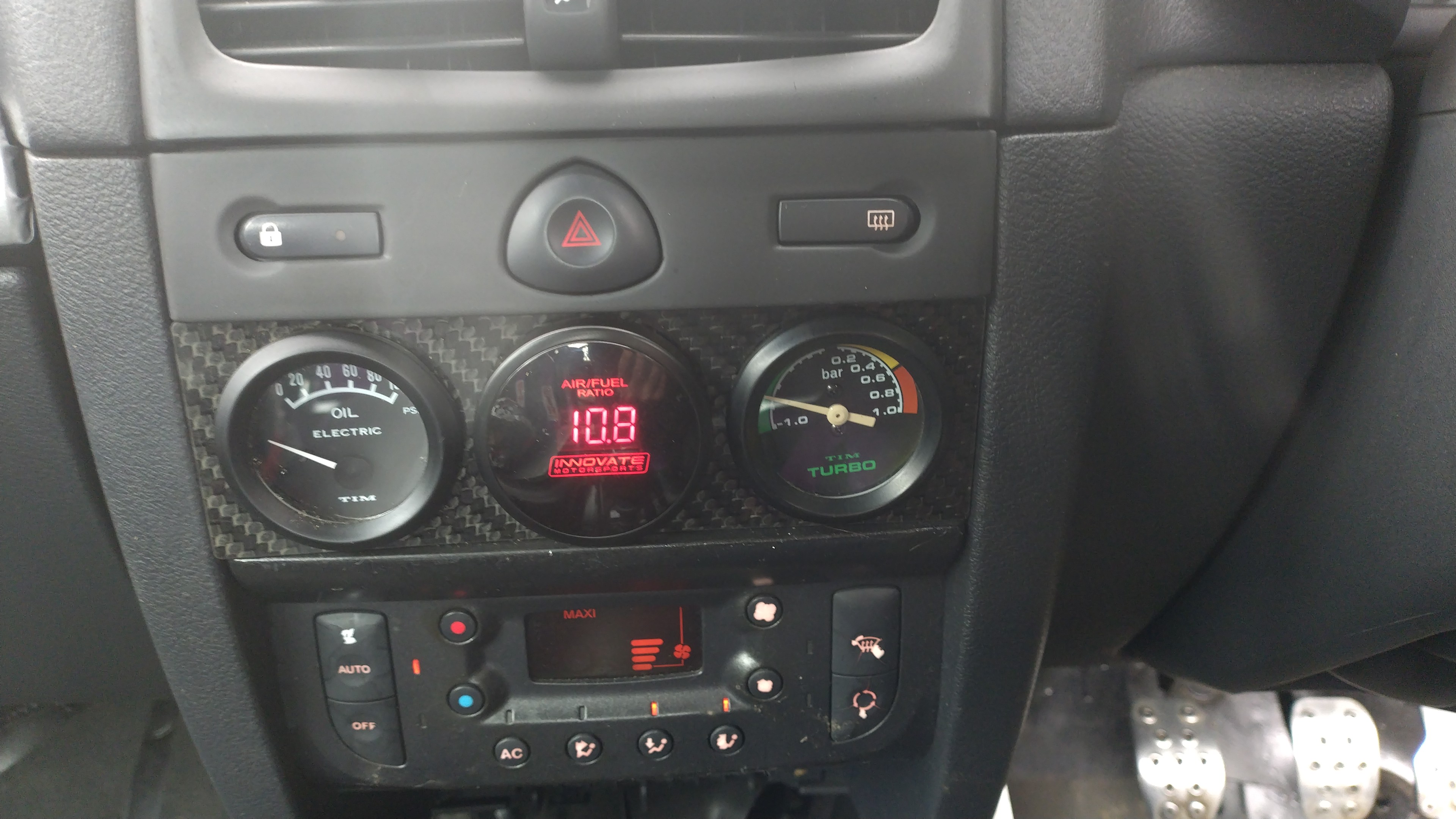

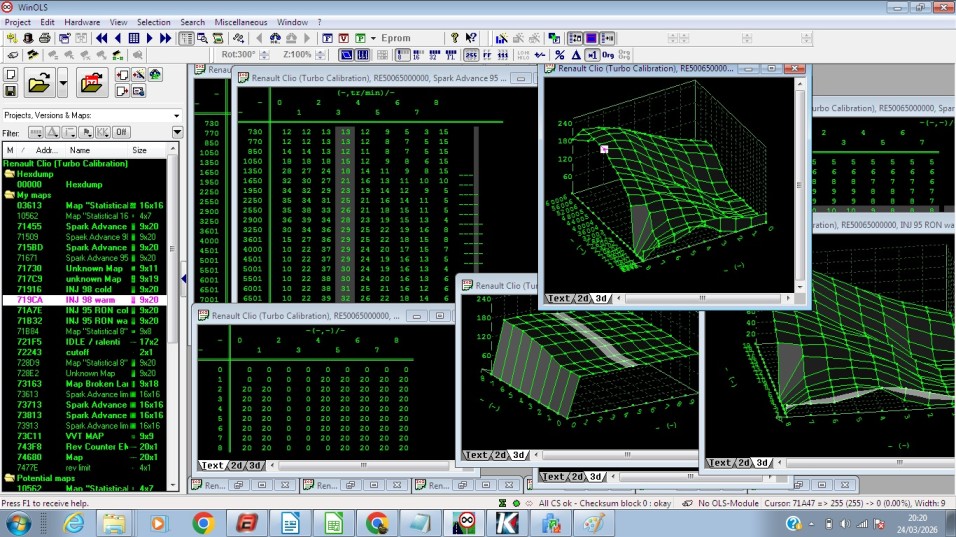

Nic from Benfleet (I don't know his user on here) kindly let me take a copy of his map, after some tinkering with WinOLS we now have a solid running driving boosted Clio 182 running 8lbs or boost and solid AFRs through the rev/boost range
(The 10.8 is cold start enrichment)
