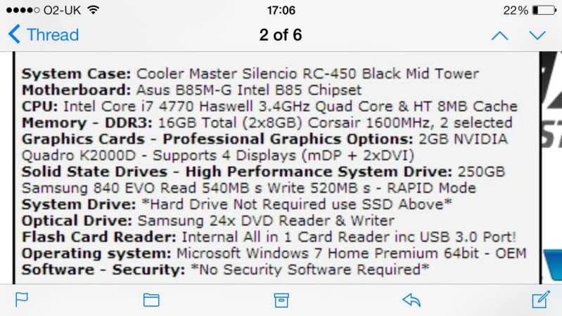

He bought two new computers last year that did the job great but with the new design software the rendering has slowed down. He needs to get a third computer but he was speccing one up and it came to £1200 on Scan...

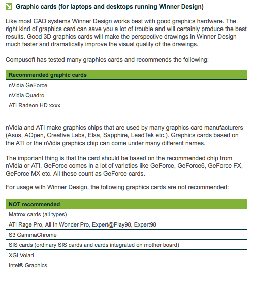

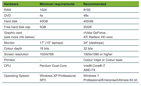

Here are the specs that compusoft say are needed for the design software Winner:
Here is what they say about recommended graphics cards:

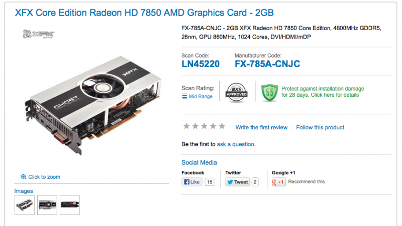

The two computers my brother got last year have this graphics card in it. From researching the card it seems it is more of a gaming card? As far as I know really it should be a specific card for rendering really?

The Geforce series are aimed at gaming, for rendering / CAD type stuff he will want a workstation graphics card, either a Nvidia Quadro or AMD FirePro.
It's funny you mentioned this, as I have an AMD FirePro W5000 which I mentioned in a thread yesterday and am considering selling and I would be interested in one of the HD 7850's.
Another option he could try is installing both 7850's in one machine and see if that copes with the load better (they work together in a mode called SLI), if so then at least he only has to upgrade one graphics card.

Looking at the specs required surely a Nvidia Quadro card for about £100 would be fine for the job?
Funnily enough I had done a bit of googling on the quadro 600 as it seemed reasonable price (£150 ish) and decent performance.

Yes mate - the processor and RAM can have a significant impact on performance. Whilst the graphics card can do a fair bit of grunt work it still needs to get this information from somewhere; hence a fast CPU with plenty of RAM is important. If the rendering process is constantly having to pull data from a hard drive (or even an SSD) before committing it for rendering then this can slow the rendering process down by an order of magnitude. I would argue that a beefy CPU on a good motherboard, plenty of RAM and a fast hard drive / SSD is as important as the GPU solution you decide to go for.

Hi mate - I've had a quick look at the software your brother is using and now I've seen what it does (and likely how it does it) you'd be wasting money buying a Quadro (or AMD/ATI equivalent). You'd be better off using a good-spec gaming-class GPU as the superior bandwidth and GPU-processing power far outweighs any advantages you'll see from the Quadro.
D'oh! B***ocks! Sorry I couldn't reply earlier but I've only recently had time to check out the software!
Which Quadro did you go for in the end, mate? And what variant i7?
Titan's are essentially crippled Quadro GK110 6000s at a fraction of the cost, might suit the bill as they're just reasonably cheap cast offs :)
I have two going at 455 quid :). They also rip through games too as an added bonus ;)
EDIT:
^ Yeah, that should handle the design software quite nicely mate. It's just a shame I couldn't get back to you quicker about the graphics card but the Quadro will do the job (and will be a decent all-rounder). If ever you get the opportunity to get something like a Titan (as per Silent_Scone mentions) then I would swap for something like that. But yeah, don't worry too much as the Quadro will happily do what is asked of it. :)
