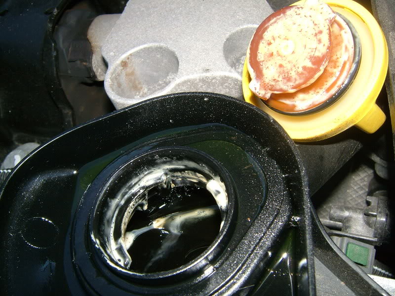

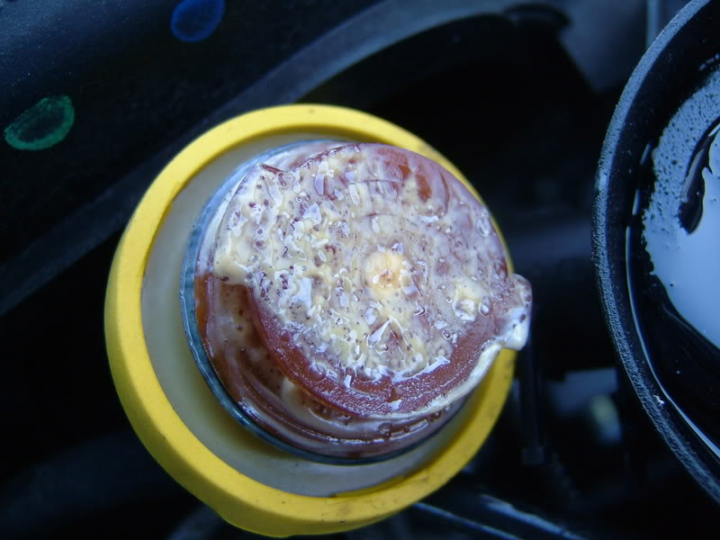

gunky crap round oil filler cap
Addz
  Trophy, TVR Tamora
just checked my oil and gave it a little top up and noticed this..
any ideas what it is and what i should do about it? my cars a 05 dynamique.... and no i havnt been having sex with it....:rasp:

As said definately the head gasket gone.
That's bad for an 05 Plate car.
Keep an eye on you coolant level and temperature gauge.

Gutted, you ain't gonna be doin much with that car for a while, let alone have sex with it.;)

Had it with my old 1.2, hg was fine. Its a triat of the 1.2 engine due to the plastic rocker cover apparently. Will most probably be just condensation unless your loosing coolant.
If the dipstick hasn't got anything on it then I wouldn't worry.

nothing around the dipstick and car drives fine, wouldnt have noticed it if i haddnt of topped oil up

its 100% NOT headgasket, that (believe it or not) is infact 100% normal for the 1.2 16V engine, its due to the plastic rocker cover
nothing to worry about

Breather pipes needs a clean out. Take it for a long run once a week.If there's nothing on the dipstick HG should be ok but don't rule it out all together.
Mayo on oil filler cap was common with Ford Fiesta 1.4s that was clogged breather pipes.
