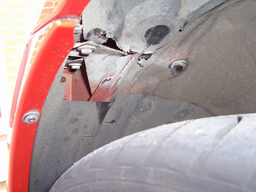

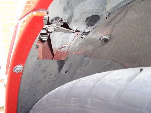

H&R's fitted, now rubbing.. *pic*

I left my arch liners in and just rubbed through them. Doesnt take long :p
Would rarely rub on the little metal bit and was very low.

this is what i did to mine...
ground the buper bracket right back.
the car did sit quite low tho...
Bumper bracket's - hammer or grind them out, most plastic on the arch liner needs moving or removing, that little bump ive said about needs removing one way or another,
Mine is that low and litrally just rubbing on one bit of plastic now :)
