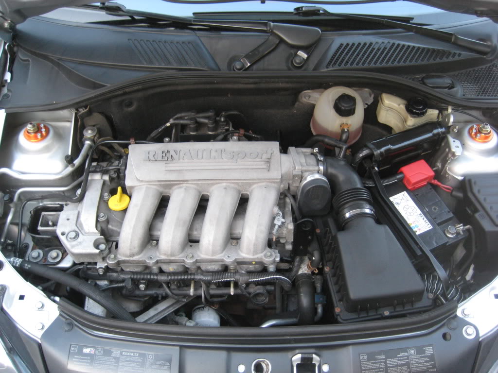

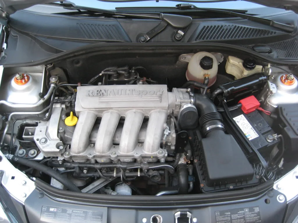

I have the AST mounts on my H&R's coilovers.
They are amazing :), mine are just set so the 3 allen keys are facing each other from each mount, think thats Maximum negative camber! :)
Might me able to see in the picture

To adjust them you need to undo the 3 allen keys and twist the mount, one way will add camber the other take it off.

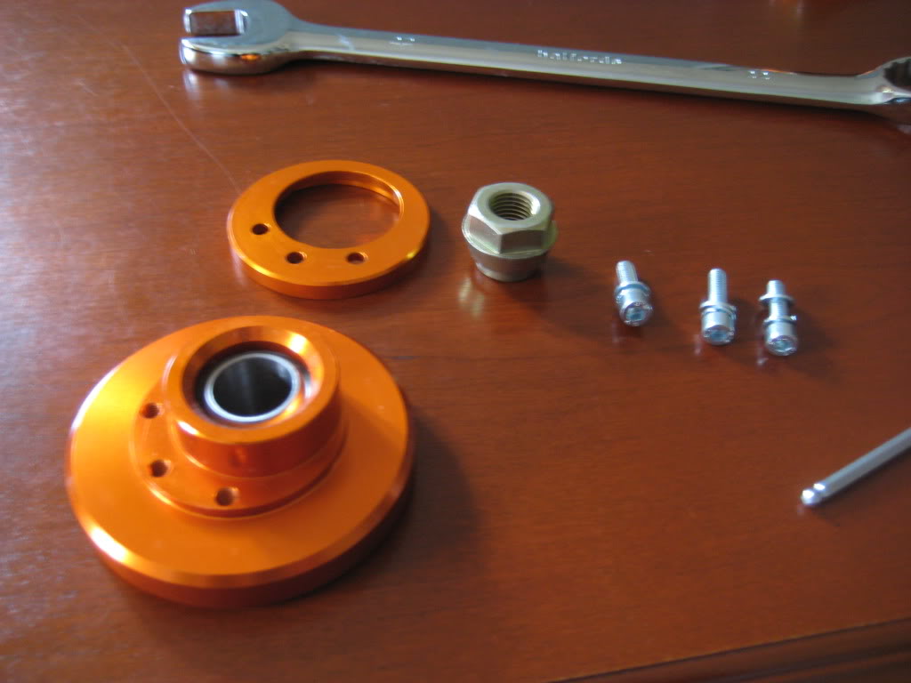

Think this is the best picture i have, you can see the row of parts are the bits on top on the car and the other part is the bit on the coilovers and under the car. If that makes sence
to get max neg camber you want the three capheads facing away from each other.
Really? Oh, i thought it was actually the other way round, As Foxy's track car has them facing like mine, So i assumed he would be running beastly negative camber.

depends what suspension your running for the max camber, i used my top mounts to set the castor and the adjustment on the coilover to set the camber.
if you look at how the top mount works you'll see that putting the cap heads towards the outside will move the top of the strut to the center of the car, hence applying more camber.
Arrr yes of course. Its a million times easyer to adjust the camber with the top mount isnt it. So where do you have yours set for the caster?
