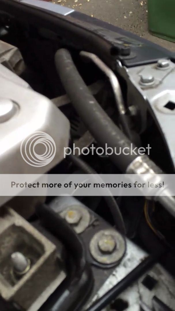

This is a strange one to describe so please bare with me, I had my cambelt, dephaser, etc done 2 weeks ago. But yesterday I noticed a 'tappetty' noise coming from the belts area ? But the noise gets worse when I move the steering wheel. I will try and video it tomorrow, but not sure how to put video's on here.

th_IMG_2321_zpsajj4xqd6.mp4

It was a video, and laptop died. Posted it on the Facebook page if anyone can have a look.

Power steering pump has packed up !!!! Say's its the first time he's known one brake ? £198 for a new one, but he managed to find a second hand one for £40.
they do die, but usually make a lot of whining noises...
Not heard any whining before, but it makes sense that its the PAS. Almost silent when car is moving but noisy when stationary, and worse when I moved the wheel.
There was no pressure in the pump when he checked, but the second hand one he had leaked. So he's been looking for a recon today, if not it's a new one from Renault :anguished:
