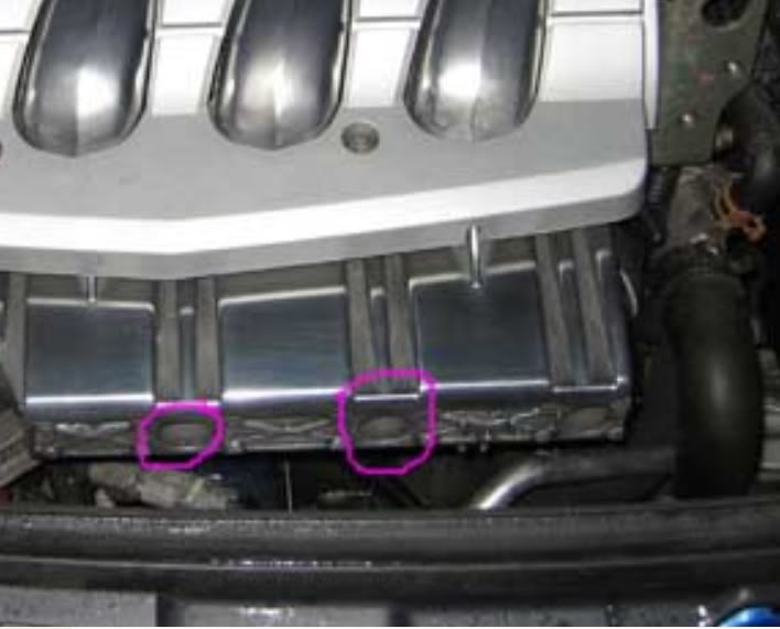

I don't think that's belt related. Is the fuel guard rail tight on the front of the engine?
See if you can move it by hand then check these studs are tight.
Thanks for the quick reply Louis.
The guard for the fuel rail has been removed by the prev. owner and provided to me detached (potentially removed to try and diagnose this issue? I deserve to be beasted for not questioning this further!)
The rattling really sounds more prominent in the dephaser area, but it wouldn't be the first time my ears have fooled me if it's coming from elsewhere.
