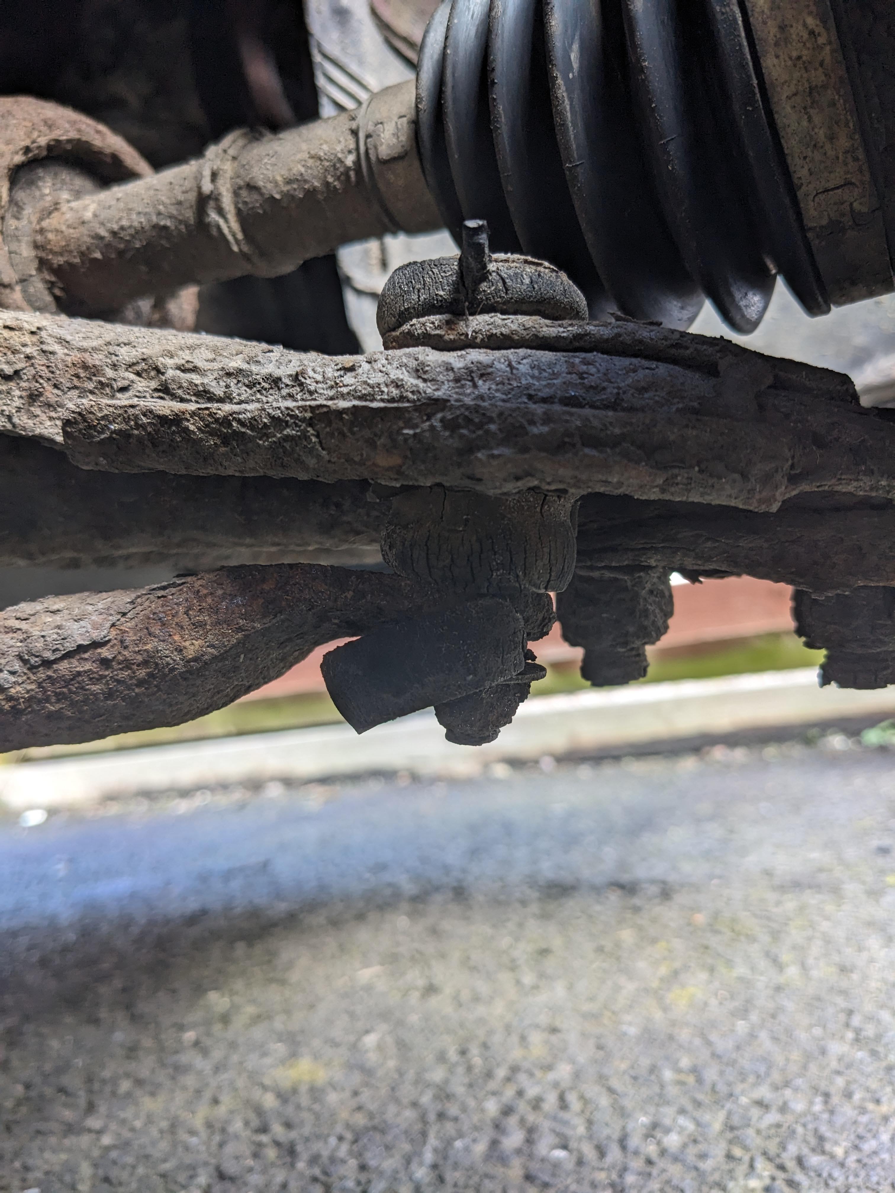

It's immaculate and passed it's MOT (all of em) with flying colours.. the most recent one has worn front roll bar bushes, so I've bought some new ones to replace it. The central ones look fine, but the ones near the drop links look squashed/vulcanized.

Outer arb bushes always fail on the lower spec, assume its the donuts that have the bolt through. Replace with mk1 clio 16v powerflex, will outlast the car.

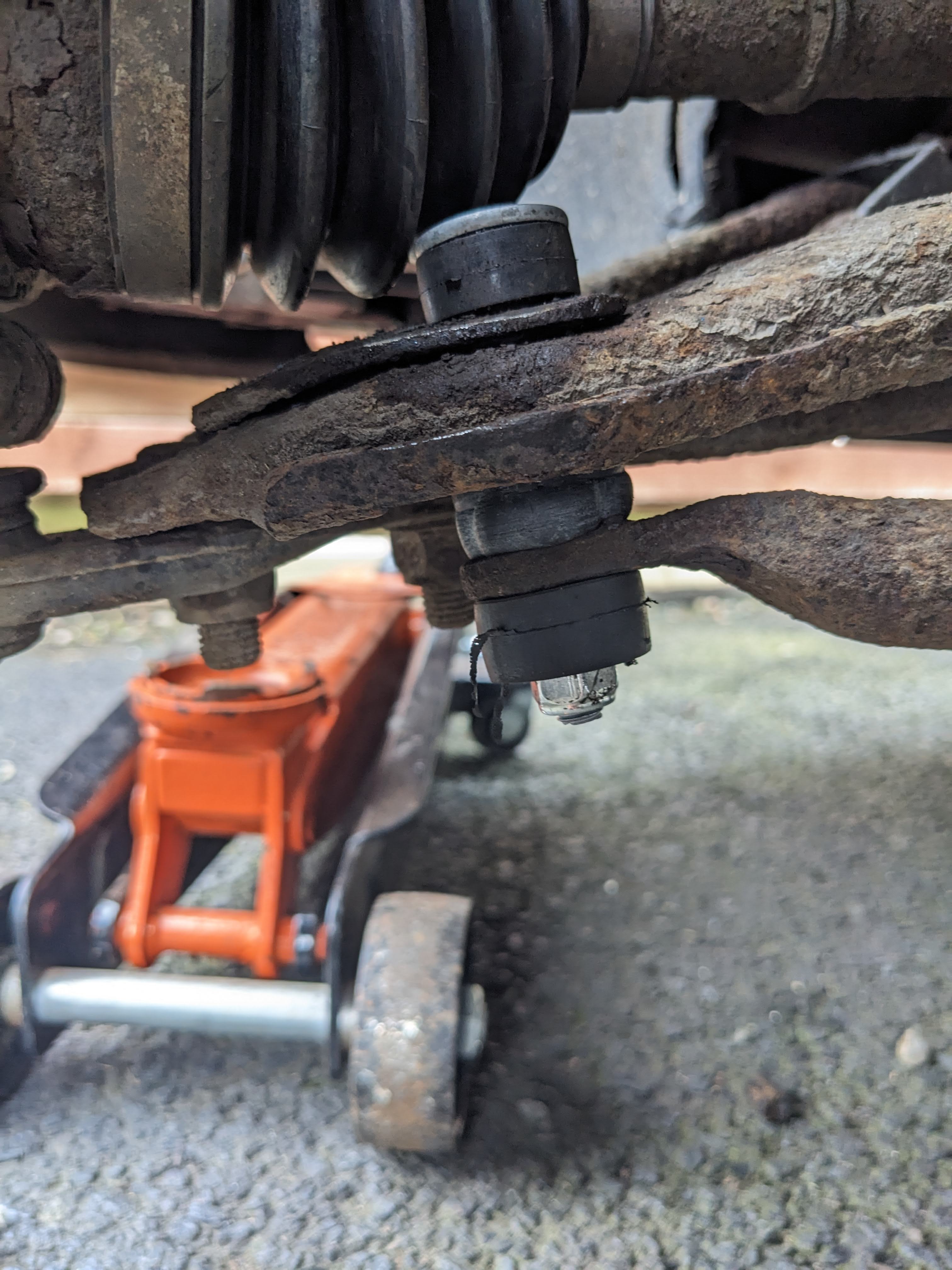

Just a little update:
Step 1 - change out the ARB bushings complete. Taking her for a spin tomorrow. Tyres next!
