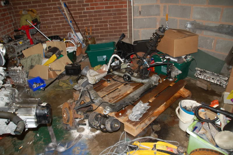

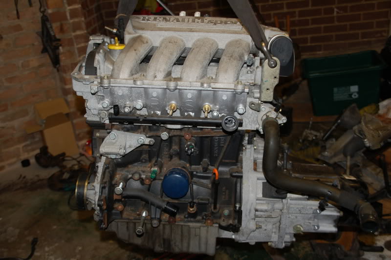

quick update, engine is now stripped from subframe

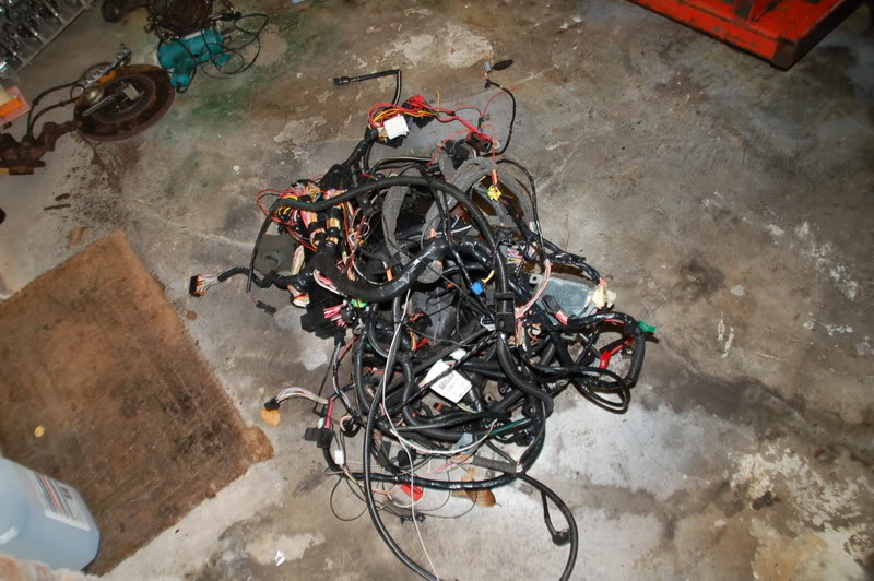

wiring anyone?? (complete 172 cup loom)

Do the simple thing junk the rear loom you might get lucky and the plugs are the same under the dah if not just take the simple option and solder up the looms rarther than striup it out.

that is only engine bay and dash loom in the pic, rear loom is plug and play

Good luck them I've seen one recinetly were the rear loom plugs on a full fat are different than Cup/normal ones so you have to cut the loom for ease.

ABS and electirc PAS is staying (you'll be surprised to learn that 1.2 16V driveshafts fit the 172 cup box, all i have to do is drill 2 holes into the 1.2 16V subframe (identical to the 172 subframe apart from 2 holes)
