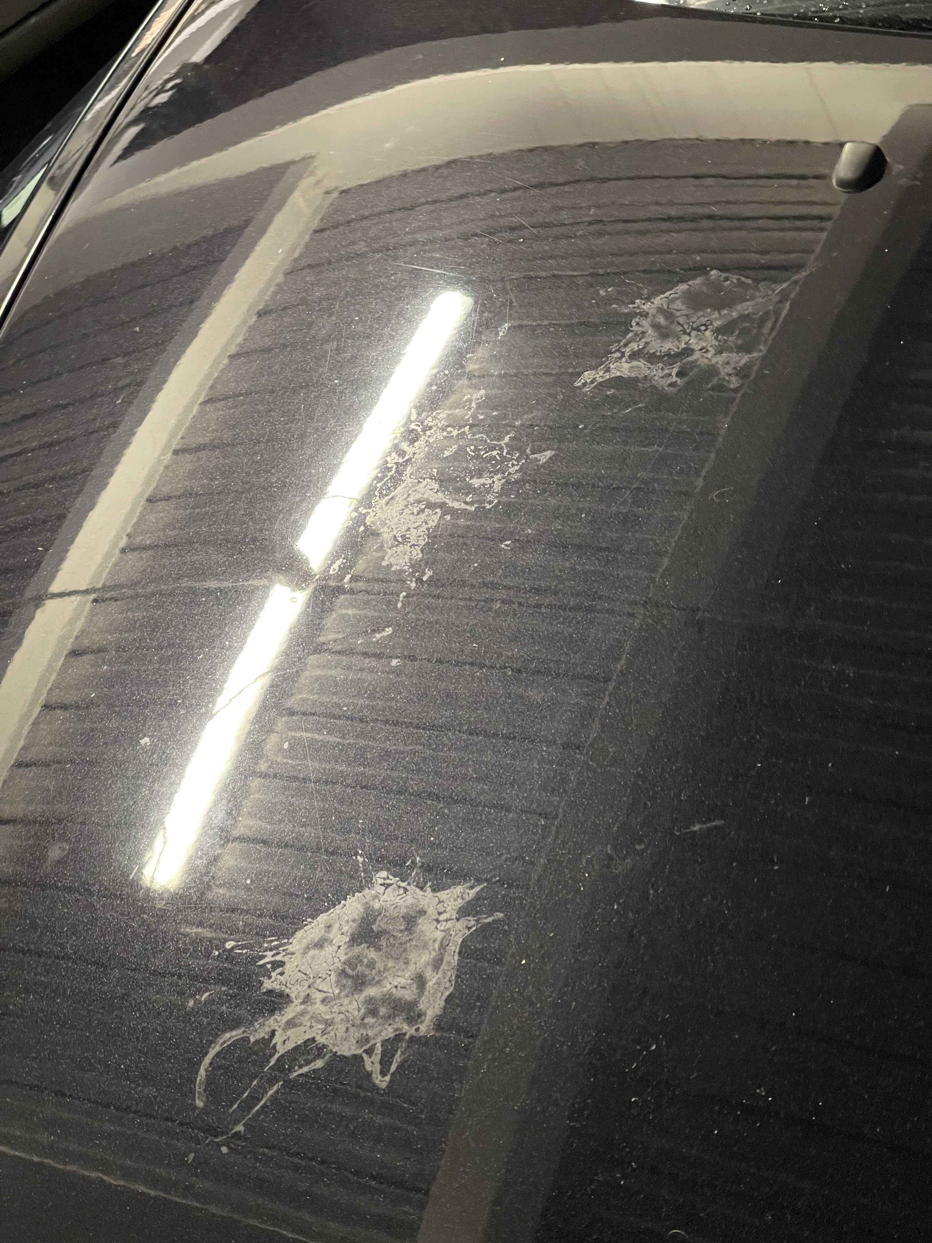

When the Volvo deaded itself I left it parked in Andover for a month. Was covered in birdshit when I got it back, lots of it has marked the paint. I’m hoping it’s something that can be machine polished out?
Doubt it will polish out.
I've got some of these to try
Let me know how they go. I think perfection is a bit much to ask but if they’re not so obvious that’s a win for me.
Fortunately they’re mostly on the bonnet so I could always get it sprayed.
Always get it off soon as it eats into lacquer surprisingly fast and you won't polish it out
What’s the process for re-lacquering? Is is just sand the old lacquer down and reapply or do you have to remove all of it?
You can use a hair dryer or a heat gun on low heat to remove bird etching quite well. You just have to make sure you don’t get the panel too hot and bubble the paint.
I’ve done it successfully on a few cars now where it’s etched into the lacquer.
