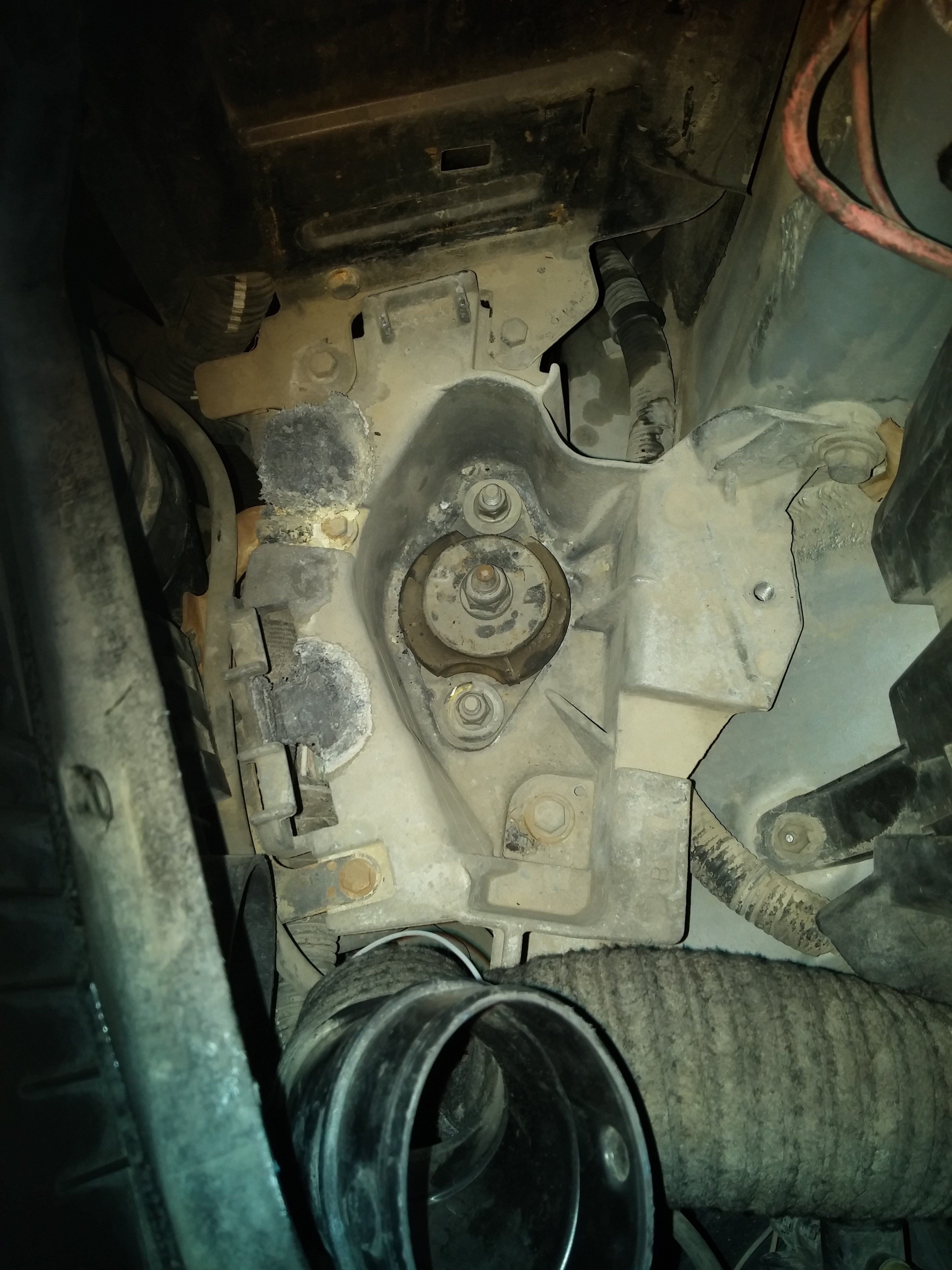

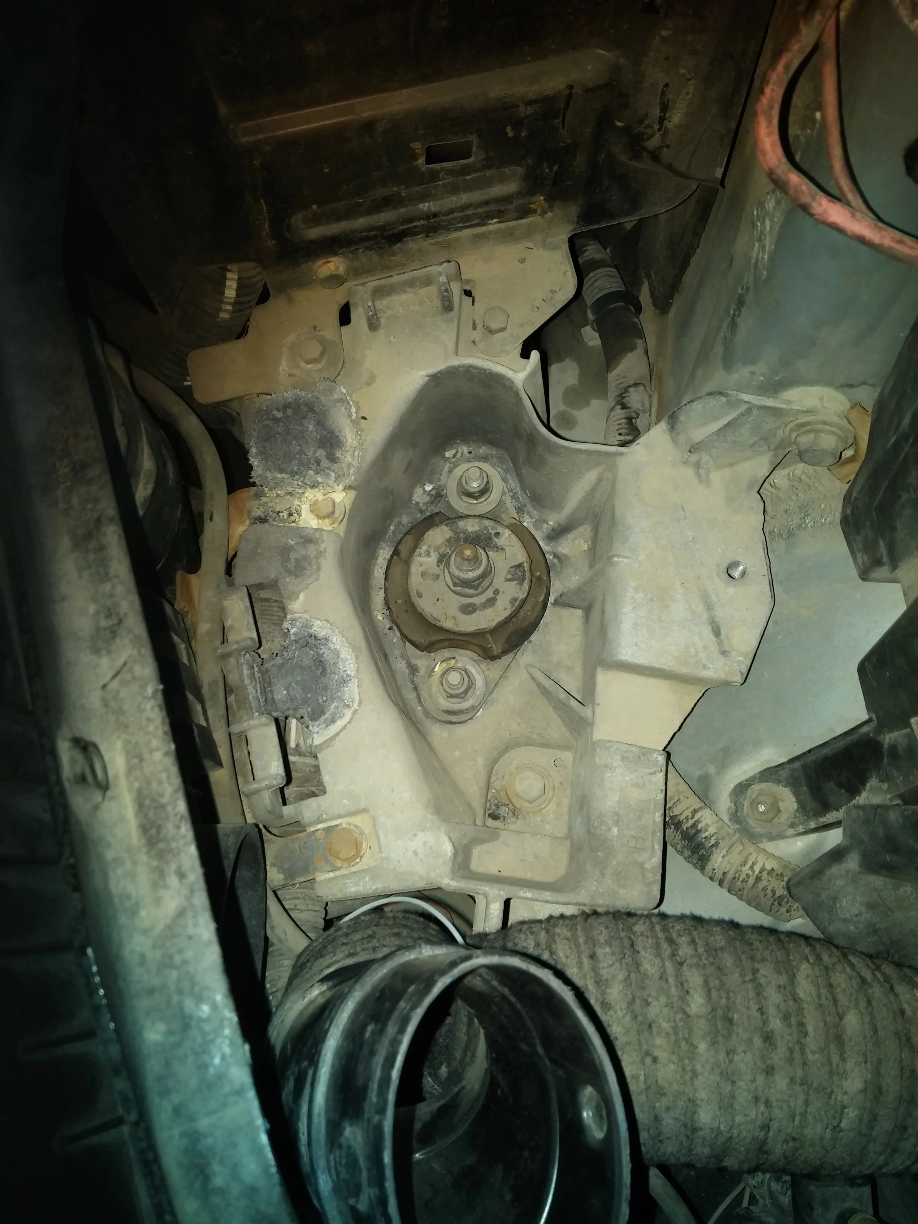

What mount could it be, and should I be able to see it's bad if it's condition is this bad ?
Could this be either lower and upper gearbox mounts ? the engine mount is good. I need to figure out which mount it is, can't go wrong as they cost a lot where I live.

Must surely be a mount issue. If they're not knackered, Try loosening the mounting bolts and pushing the engine towards the firewall before re-tightening.

This is what the top gearbox mount looks like

Top engine mount looks ok, last owner says it's 1 year old, maybe you can tell me it's condition from the movement in the video. I don't get any knocking when flooring it in first btw.

Eyes, lever bar... The engine should move, but not easily...
Id have ordered a full set of mounts and been done with it.. I wouldn't even look, I try to find any excuse to replace old worn rubber parts
