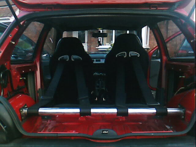

ive got a mk1 clio, with cobra bucket seats, cage etc, im looking for 3 point hasrnesses that are able to wrap around a harness bar, i can only seem to find harnesses with the clip or bolt in type?
Can anyone shed any light?

I think you will find all belts come with the clip.You just take the clip off and wrap belt around bar and then feed the belt through the adjuster.Do a search you will see what I mean.

Your harness will come with a clip on the end and a adjusting slider.remember how you undo the adjuster,do a little drawing if needs be,take off clip,wrap belt around bar then put back through adjuster in the same way,sorted.

thanks for all the help guys, sort of makes sense now, and Tony that pic is exactly what im trying to achieve!!
