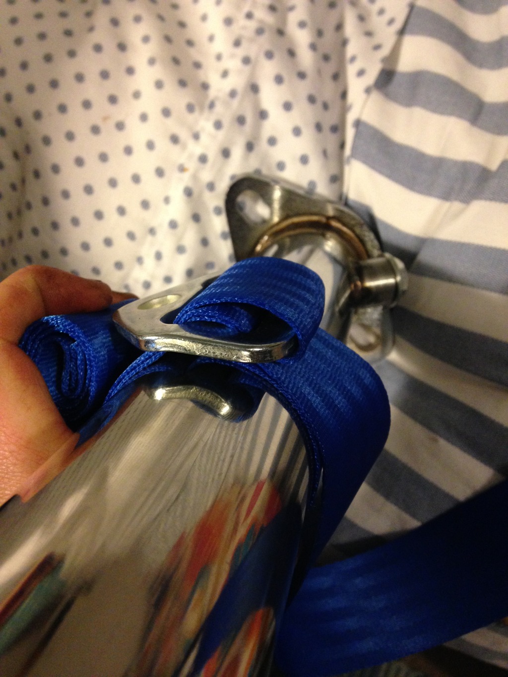

I think I'm being a total pen 15 but how do you actually go about mounting the harness'. I'm looking at getting some 4 points for my car which is going to have a cage in the back with harness bar. Two questions.
Do all harness' have the ability to mount to a harness bar and if they do what extra bits do I need to do that.
Where do the lap belts mount to?
Once I get my head around this and see an example I'm sure it'll be fine :) just don't want to risk doing it wrong for obvious reasons.

Not all harnesses will wrap around a cage bar. Ensure you buy ones that will if that's what you intend to do.
I've only got a harness bar on the drivers side of the cage, so added a clip buckle to the harness by threading it though - I had that option.

@ilovewilly The ones I have seem to be able to wrap around the bar okay. I just removed the 3 bar slider and did a test wrap. Will get the correct slider bars and then pop them in. Having seen a couple of different fits of the lap belts I'll get the seats in, position them up and only then get drilling.
