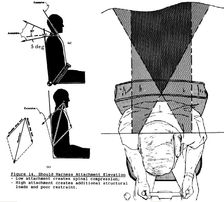

Guessing the same as an RS, The two lower front seatbelt mounts and use the lower two rear seatbelt mounts. I can show you where I mounted mine to later. I might let my Sabelt 4-point clip in harnesses go if the price is right
Look at this guid using the lower steat belt point is stupid will cause you serious risk in a crash as it compresses your back when yuor throw orward.
There no ideal place realy unless you've a cage. Personaly I'd use the top mounts where the rear belts go for a feew reason.
Its safer in front end crashed (if someone crashes into the side them its higher risk as it will pull you into the seat)
Frees up the boot.
It isn't at the bottom of the seat which is a dangerous place to mount.
