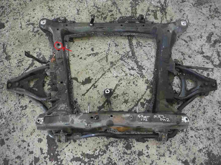

Unfortunately, I damaged my car a few days ago, and I'm currently looking for a front subframe (engine cradle) for a Renault Clio 2 RS 182 Phase 2.
I've been doing some research and reading through various forums, and I've come across several discussions suggesting that the subframe from a standard Clio 2 might fit the RS as well.
My questions are:
    • What's the actual difference between the subframe on a standard Clio 2 Phase 2 and the one on a Clio 2 RS Phase 2?
    • Are they interchangeable, or are there differences in mounting points, dimensions, or suspension geometry?
    • Has anyone here actually fitted a standard Clio subframe to an RS? If so, what was your experience?
    • Is there anything specific I should check before buying one?
I'd really appreciate feedback from anyone who has dealt with this or has first-hand experience. I'd rather hear from people who have actually done the swap than rely solely on what I've read online.
Thanks in advance!
I'm no expert, but I'm going to say, false. The subframe mounting holes, not just for the 4 bolts where it attaches to the car but all the other gubbins, will be RS specific. Also the weight of the engine and gearbox.
I believe 172/182 subframes are interchangeable. They're quite readily available and reasonably cheap too?
