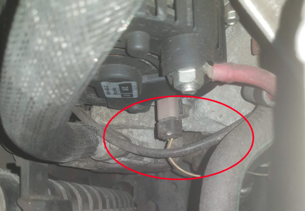

Thanks for the heads up. I am just wondering whether it may be a connectivity issue - when I corner hard in one direction, the warning light disappears :unsure:. Looking down at the alternator there is a plastic wiring clip that looks like it should have two wires from it but one has frayed
1426944
Does this look wrong? Anyone know a good way to test this sort of electrical gremlin
