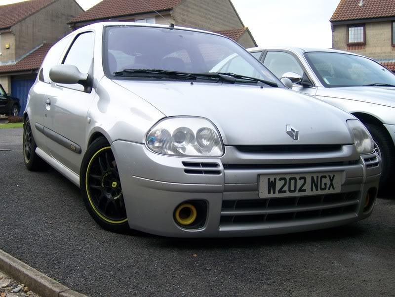

Clios do this anyway, with seperate H7 bulbs. H4's dipped extinguish when main beam is selected, if both filiments are on, the bulb would overheat imo
