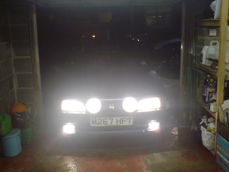

I had a bash at mine today, I ran a feed from the Red cable of the interior light to the middle pin of the headlight relay.
Now... i got mixed results, mainly the lights were just flickering, once they functioned how i wanted them to, but I'm thinking the poor results may have been down to the cable i was using, and ideas as what a decent one to use might be. It needs to be quite flexible to slide in with the relay pin.

I just worked on a process of elimination! There are 5 pins in total, 3 in a line at the bottom, 1 in the middle on 1 at the top. In a sort of T shape.
The middle one is the correct pin. The most annoying thing is dutty_112 has done it but won't offer any help!
